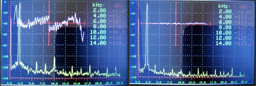

Pictures help to understand all processes.

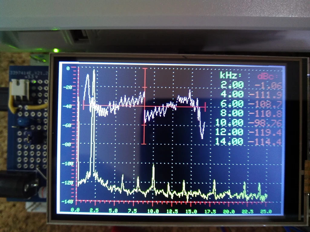

was done on nucleo-stm32G474re board. It has 12-bits ADC capable to do oversampling and run in differential mode. Both features were activated, OVS = 64, sampling rate 2.8 Msps drops to 43.75 ksps after OVS. 4096-FFT Split Radix, DIT and DIF for reverse part.
Segments table 10-bits. All software including calibration subroutine and SA part (shown on LCD attached) was running on the same G474re.

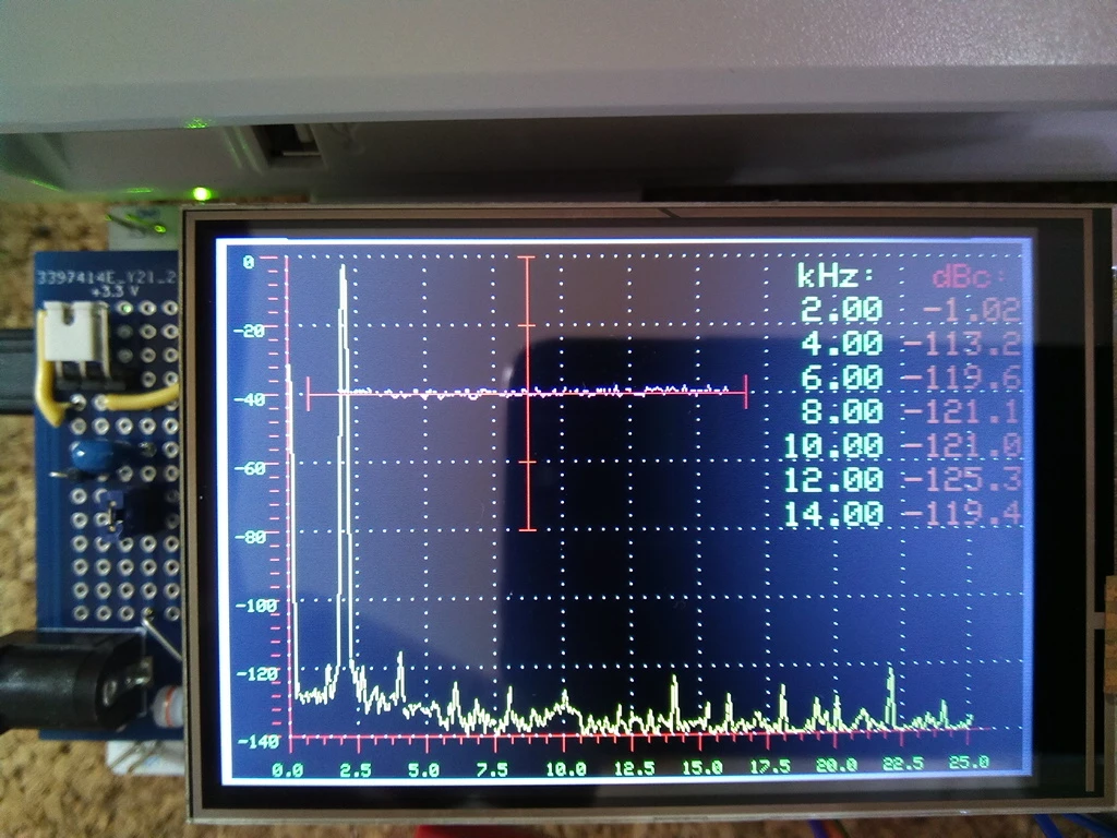

Over 20 dB improvement for 3-rd harmonic demonstrated. That’s more than ten times, bringing INL from the initial typical ~2 LSB down to less than 0.2 LSB.

Stability verified, calibrated board (with LUT stored in the flash memory) effectively demonstrated the same low distortion spectrum when powered on the next day.

Hardware implementation in overall shows lower efficiency that software modeling (THD level -102 dB vs < -122 dB). That’s may be explained by complexity of the INL curve for SAR ADC. First of all, memory limitation doesn’t allow to run FFT more than 4k, and high noise level of the internal ADC forced me to activate OVS in order to get charts noise level below -110 dB.
Two INL curves for 2 kHz & 200 Hz test signals shows that OVS plays bad role “smoothing” all edges for higher frequency. I’m sure method can demonstrate better results for SD ADC, where INL curve looks different, w/o sharp edges.

The method of static ADC non-linearity correction was applied to internal H7 ADC-1.
The screen image shows some updates, with the INL chart drawn over the SA spectrum in the upper left corner.
Scale X-axes: -32768 ... + 32767 remapped down to 256 pixels.
Y-axes: overall span 4 LSB, snapped with a dB scale as 20 dB to 1 LSB.
Doing so, I can instantly observe how slightest INL changes affect harmonics distortion and vice versa.
Conclusion: the method demonstrated improvement of the ADC linearity up to 1 ppm.
