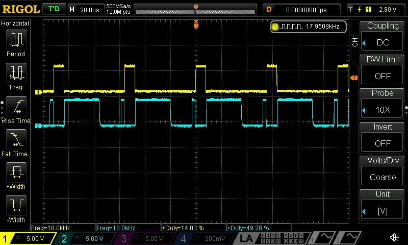

When I enable the ADC1 Scan Mode and DataBuffer with ADC_Channel >= ADC1_CHANNEL_2 TIM1_CH2N waveform distorted.
Oscilloscope CH1(Yellow) -> TIM1_CH1N
Oscilloscope CH1(Light Blue) -> TIM1_CH2N
For example when ADC_Init() with ADC1_CHANNEL_2

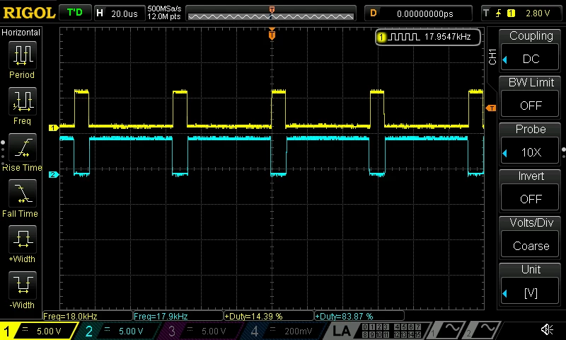

when ADC_Init() with ADC1_CHANNEL_1

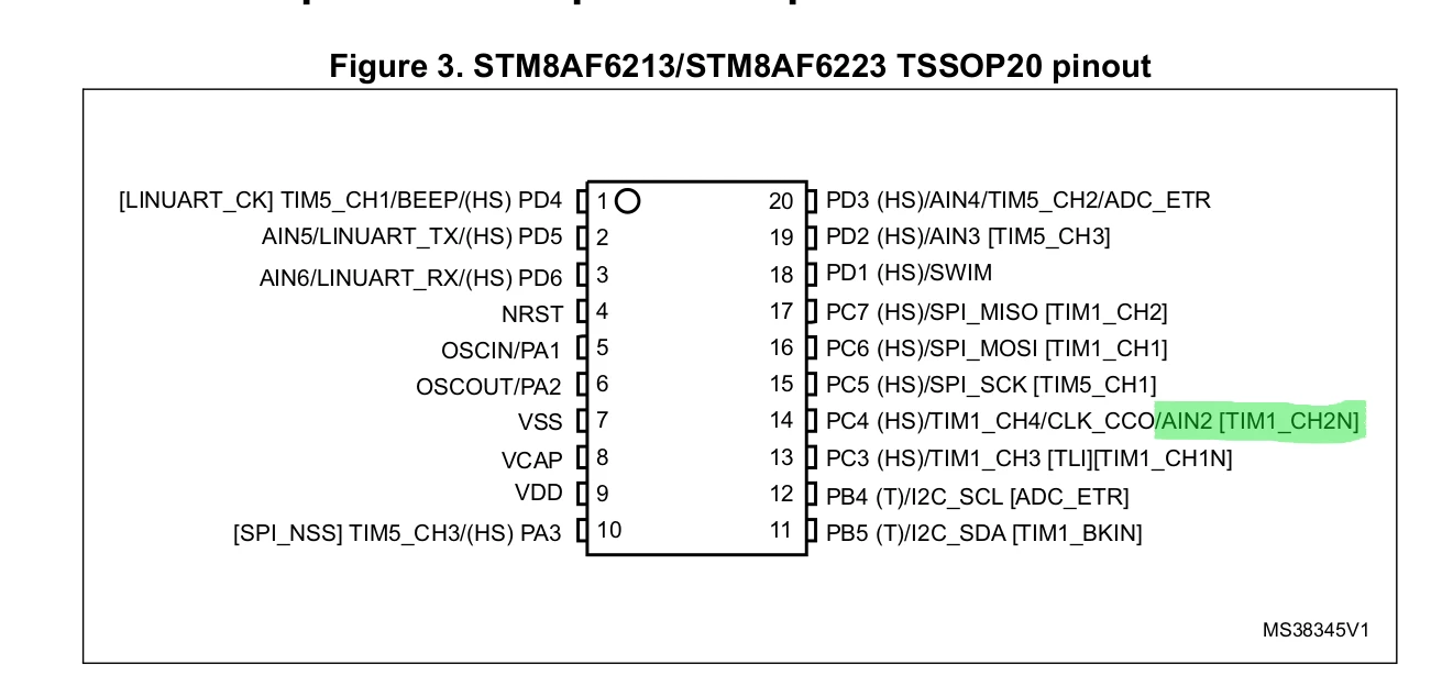

ADC1_CHANNEL_2 is the AIN2 but Before the operation, i program the option bytes for enable the complementary channels.
What causes the distortion?
Best regards.

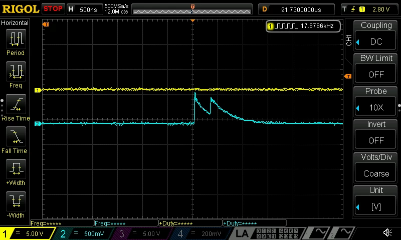

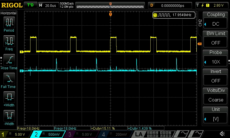

I also try disable TIM1_CH2N with TIM1_OC2Init() function i realized that ADC sampling effect that pin .

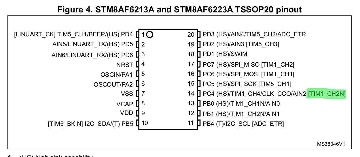

    Edit: I put the wrong MCU picture. Take care this.

    Hi, i think you misinterpret,
    I configure PC4 as a CH1_CH2N.(Its alternating property is AIN2 but i didn't configure it to ADC)(before, i program option bytes to enable complementary channel)
    GPIO_Init(GPIOC, GPIO_PIN_4, GPIO_MODE_OUT_PP_LOW_FAST); // CH2N
     I want to use PD3 pin as a analog configruation -> AIN4
    I can able to read PD2 (AIN3) but when i need to get AIN4 and AIN3 same time i enable ADC scan mode
    But when i calling this for this purpose
     ADC1_Init(ADC1_CONVERSIONMODE_SINGLE, ADC1_CHANNEL_4, ADC1_PRESSEL_FCPU_D2,
     ADC1_EXTTRIG_TIM, ENABLE, ADC1_ALIGN_RIGHT, ADC1_SCHMITTTRIG_ALL,
     DISABLE);
    It create a problem PC4 that prevously defined as a Timer channel.
    I didn't define it as a ADC previously
