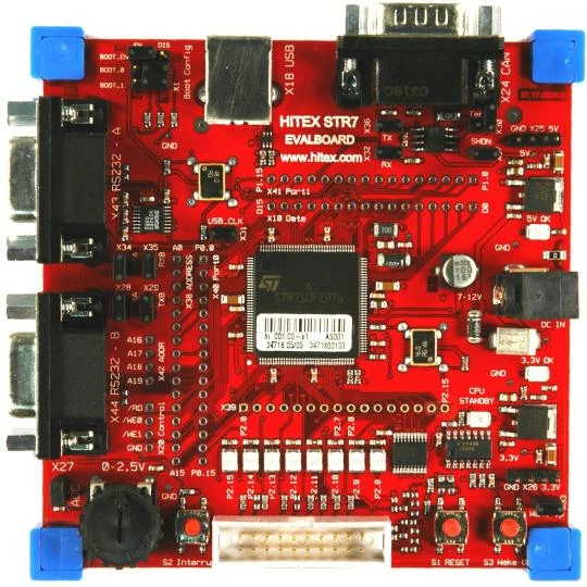

I am working with a STR710FZ2 (on an evaluation kit from Keil, MCBSTR7) and have some problems with the adc resolution.
I supply a voltage of 1.5000 volts to adc0 and use a sample frequentie of 1 kHz. When I monitor the adc registers the value varies with 5 counts.
(5/4096 * 2.5 = 3,05 mV). since the there is not that much noise on the input signal, I would expect the adc value to be stable.
Is there something I can do to get a better resolution?

Are you sure that the noise is not due to your analog input?
regards,
Hich
swiggers9
swiggers9Author
September 19, 2006
Posted on September 19, 2006 at 12:18
yes I'm sure. the analog input is very stable. I did the same test with a different microcontroller and the results were fine.

How do you supply AVDD? The datasheet says that power to the ADC should be filtered.

after some more research I found that the problem has something to do with the RS232 connection. I have a program which polls parameters via rs232 every 10 msec. When I haven't started the connection everything works fine and I see a noise of about 1 mVolts which is ok.
But after making connection the noise increases on the entire board with about 3 mVolts. so this explains the difference of 5 counts in my adc ((0.003/2,5) * 4096 = 4.9)
but I still haven't found the cause of the extra noise.
here are the board I'm using and the schematics.
If you have any suggestions I would love to here it.

In the ADC spec there is the following note:
Any added external serial resistor will downgrade the ADC accuracy (especially for resistance greater than
10kΩ). Data based on characterization results, not tested in production.
