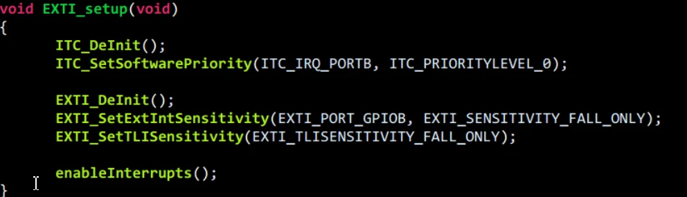

In this code,
I understand the line
''EXTI_SetExtIntSensitivity(EXTI_PORT_GPIOB , EXTI_SENSITIVITY_FALL_ONLY);''
It means EXTI detects falling edge, right?
But what's the next line means??
''EXTI_SetTLISensitivity(EXTI_TLISENSITIVITY_FALL_ONLY);''
I read the reference manual about EXTI section but there is no enough information about TLIS..

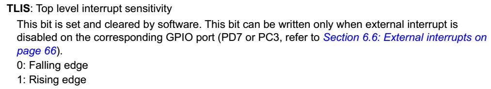

    the note you showed up says it clearly: it is the sensitivity for the TLI pin.

    I understand, this pin PD7 cannot be acting with interrupt in the same time with PD0,PD1...6. Is it correct?
