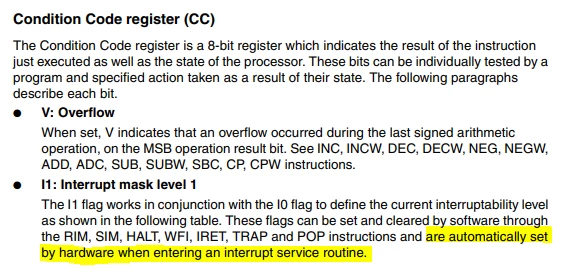

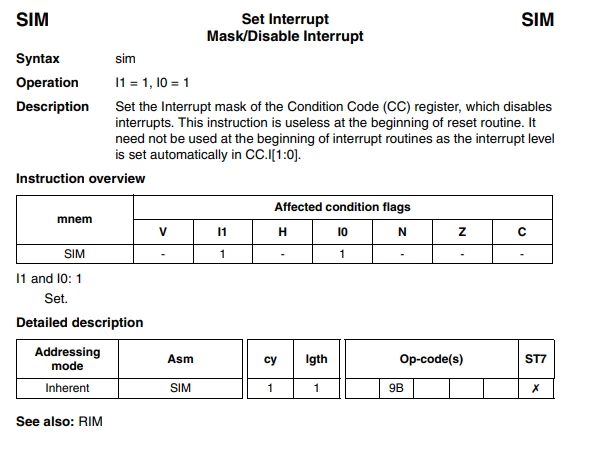

I test push and pop instruction,some issue confuse me. ​
push cc #cc = 0
​when cc=0,and cc is push to stack,the value in stack is 0x28,this mean I1 I0 is set,why?
pop cc​ #cc=0
when​ cc in stack is 0x2b,after pop,cc change to be 0x3 ,this mean I1 I0 is cleared auto,why?
the behave is correct?Please help me.
thanks.​

    Hello @jduo.1​ ,
    0693W00000D0JDGQA3.pngAre you sur that no interrupt happened while you're stepping?
    Could you disable the interrupts using SIM and retest your code?
    Disclaimer: I've never used STM8, I've just skimmed through PM0044.
    Best regards,
    @SBEN .2​

    I use STVD to debug, the program is not exsit ....
    maybe this is caused by stm8-gdb.
