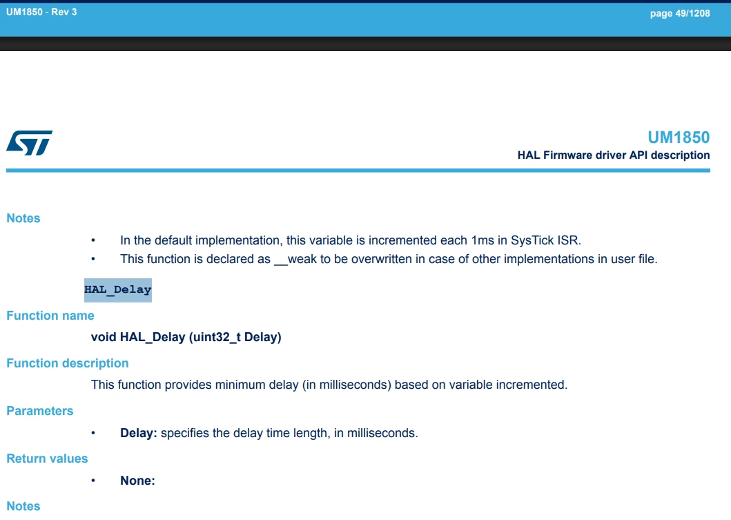

Also what is the significance  of  "void delay (unit16_t us)"  and "HAL_Delay()".
HAL_Delay() does a delay of N to N+1 tick periods by waiting for N+1 ticks. If the systick time is set to a period of 1 millisecond then HAL_Delay(10) does a delay from 10.0 to 10.9 millisecond depending on when you call the function (if a tick just happened it will take longer).
delay() is a software delay by wasting CPU cycles. This is usually poorly defined as it depends on compiler, MCU type, clock, etc. And in case of optimization it might be optimized out as it doesn't do anything.

what is the significance  of  "void delay (unit16_t us)"  and "HAL_Delay()". .
The clue is in the names - they provide inline delays:
Note that all the HAL functions are also documented in comments in the source code:
 * @brief This function provides accurate delay (in milliseconds) based
 * on variable incremented.
 * @note In the default implementation , SysTick timer is the source of time base.
 * It is used to generate interrupts at regular time intervals where uwTick
 * is incremented.
 * @note ThiS function is declared as __weak to be overwritten in case of other
 * implementations in user file.
 * @PAram Delay specifies the delay time length, in milliseconds.
 * @retval None
__weak void HAL_Delay(uint32_t Delay)
