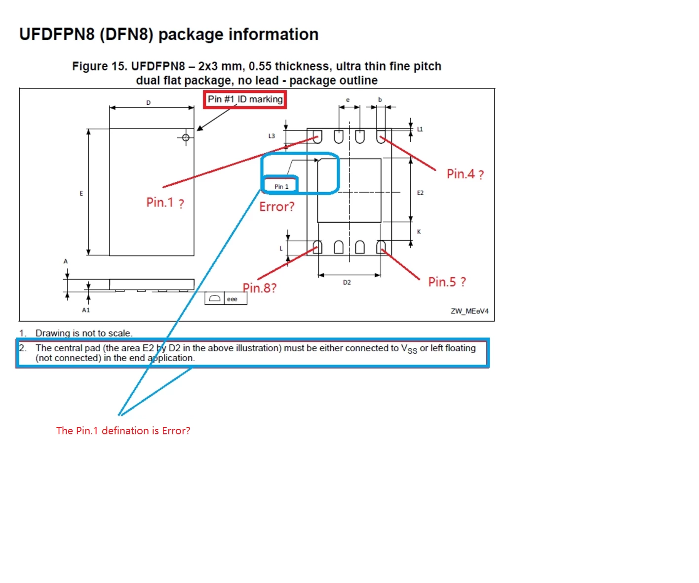

1.Are there a error for the Pin.1 defination of M24512 with UFDFPN8 (DFN8) package; 2.Pls confirm the UFDFPN8 (DFN8) Pin defination Ok or not as my mark in red(Pin.1/4/5/8).

Of course the Pin 1 is defined as you mentioned in your red comment !
Thanks for the flag.

Other Pin define such as Pin.4/5.8 are all OK also as our mentioned?

​Once you have pin 1 identification, you have to follow 8 pin package connections ( figure 2 in datasheet).
==> I do confirm pin 4/5/8 as you described.
