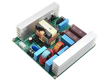

Also available, the EVL4983-350W demonstration board accelerates development of switched-mode power supplies using the L4983. The board implements a 350W PFC pre-regulator with universal input-voltage range and provides a regulated 400Vdc output, with low THD (Total Harmonic Distortion) across the load range and efficiency of 97.4%.
