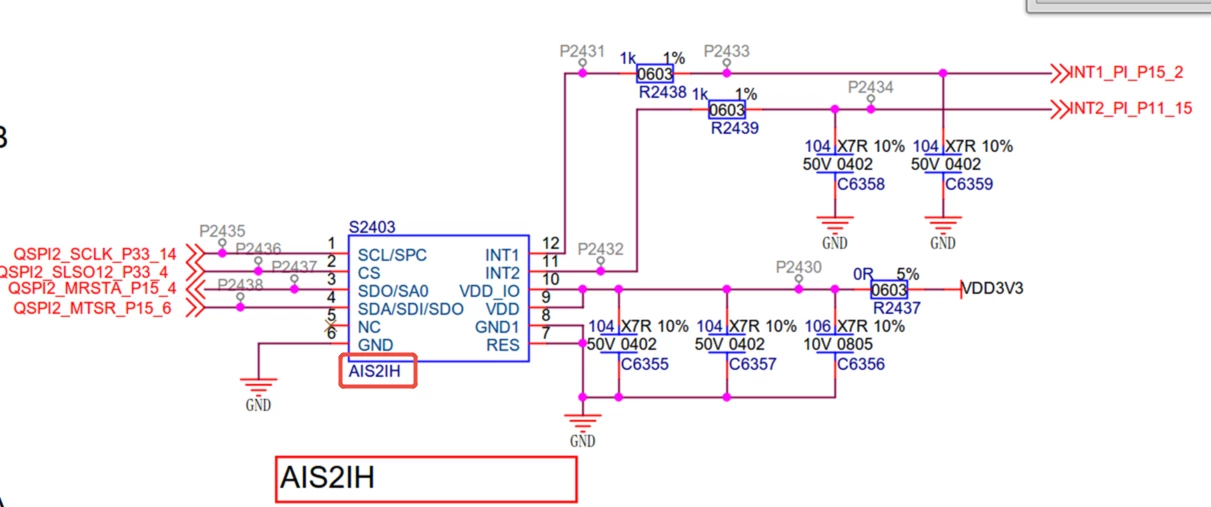

We have used the official code, but the measured values still do not match the actual situation. The most intuitive example is that when we apply acceleration on the X-axis, the X-value reads 0 while other axes show values. Could it be that our hardware connection method is incorrect? Could you please help evaluate it? Here is our schematic diagram.
Thank you very much!

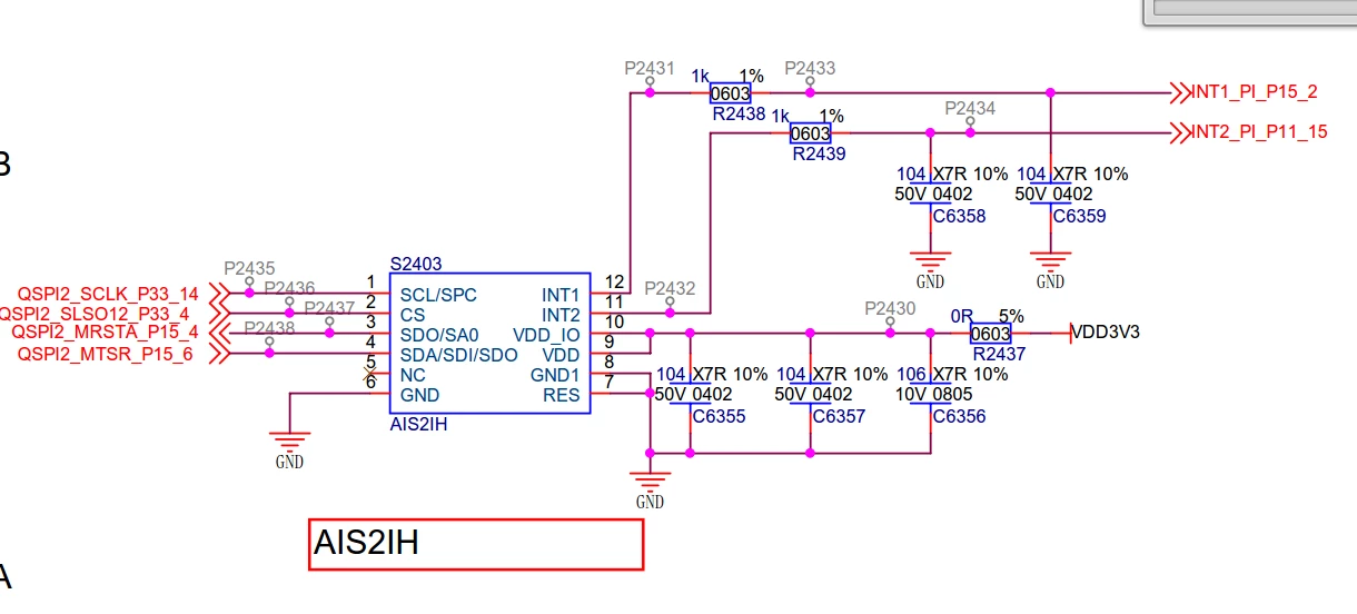

When we apply acceleration to the X-axis, the displayed acceleration value of the X-axis is 0, which is obviously incorrect. We have referred to the data sheet and official code, but still failed to find a solution. Here is our hardware schematic diagram. Could you please help evaluate whether it is reasonable? Thank you very much!
Do you see the same when you move in the other axes?
At rest, do you see ±1g in each axis, according to orientation?
Maybe there's something wrong in how you display it, and/or how you process it?
Have you looked at the raw values received direct from the sensor?
