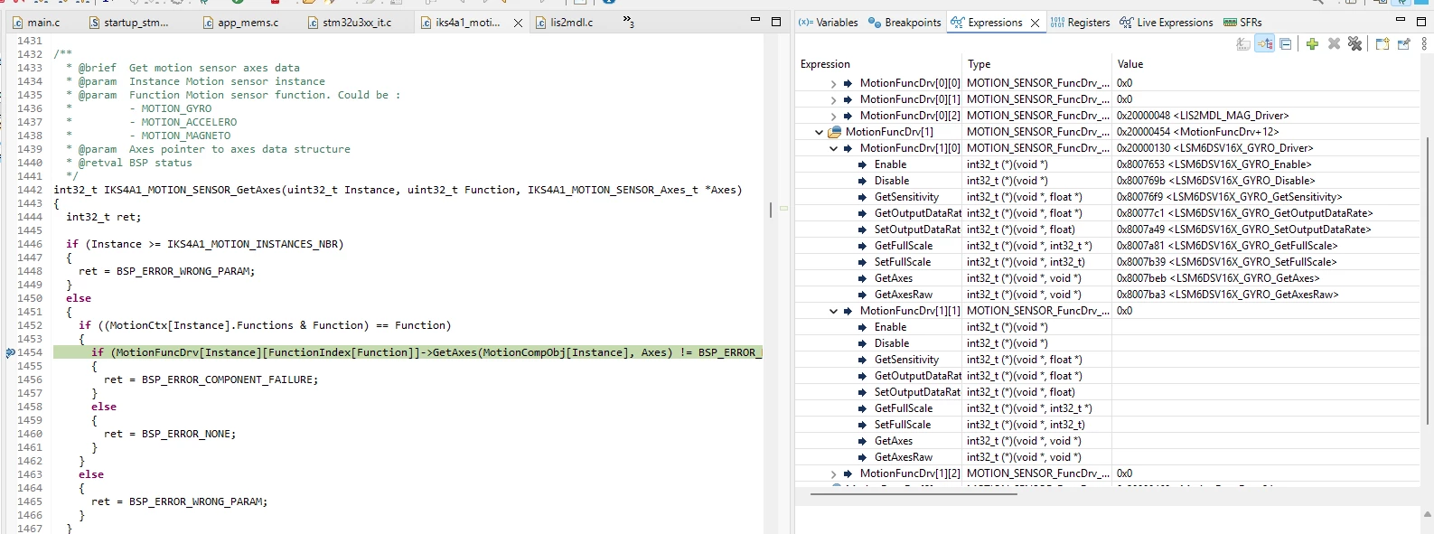

I'm facing some trouble with interfacing these two boards.
Right now, I had only configured cube to load the datalogger example.
It's running fine without the 6283A1 but when I plug it on the IKS4A1, the code crash.

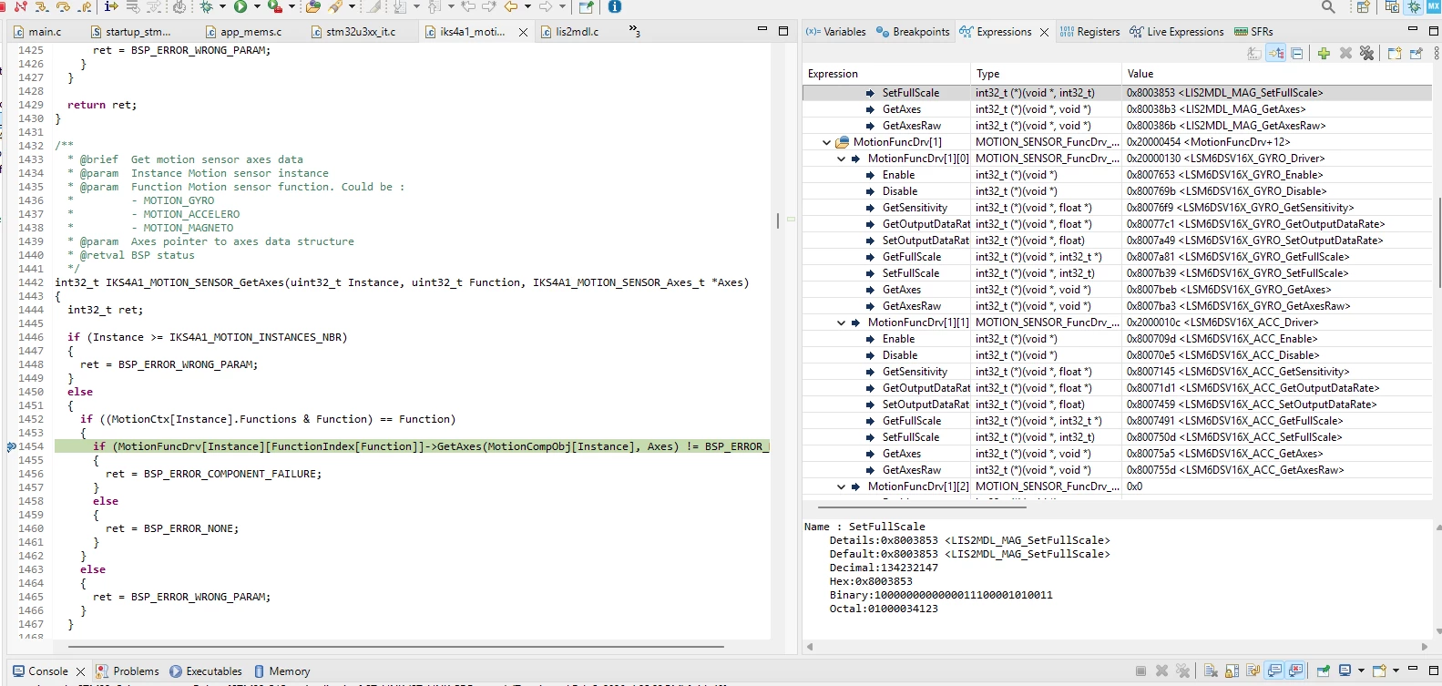

While debugging, I found that when the 6283A1 is not installed, the "configuration" variable is correctly filled with correct function pointer :
But when the 6283A1 is inserted, not all the variable is filled and the code is trying to execute a function that's not registered in the variable :
MotionFuncDrv[1][1]->GetAxes
I think it's a bug in the IKS library, the color sensor may have been interpreted as the LSM6 ?
Althought, the I2C bus is working fine.

Hello @AlexJ
I have tried to replicate your setup using NUCLEO-F401RE + X-NUCLEO-IKS4A1 + X-NUCLEO-6283A1. I tested DatalogTerminal and DatalogExtended from the X-CUBE-MEMS1 package, as well as the 6283A1_LuxCCT example from the X-CUBE-ALS package. All the examples worked fine and communicated with the sensors. So, from the hardware point of view, it should be OK, and there might be a bug in the firmware. Could you please double-check your project or alternatively share it with me so I can review it?
