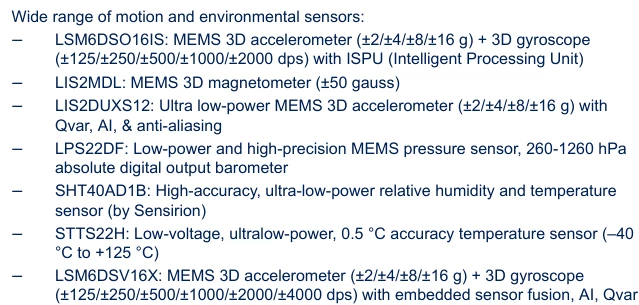

I just started with the ASM330LHHX DIL24 module for the X-NUCLEO Boards, the module is listed as compatible with the IKS4A1 (sensors below):
I have read some documents related to the procedure to make it work but it's an "old" document (see below), I look for general advice:
  • Once the module is inserted do I need to configure any jumpers in the XNUCLEO board?
  • If there is no need to modify jumper configuration on the board, does that mean that all configuration is done via software, correct?
  • Once I gain access to the ASM330, the rest of the sensors onboard the IKS4A1 will be available? all of them + the ASM330?
> If you have a tip or advice related to the configuration to enable the ASM3330 feel free to share it.

Hi @Pantera_MXJ ,
If STEVAL-MKI212V1 must be used, it is mandatory to remove the I2C address conflict as explained in UM3239 (chapter 3.6). To remove the conflict (with LSM6DSO16IS), it is mandatory to open the solder bridges SB38 and SB39.
Please verify also the presence of R27 and closure of SB44 (that creates right address on STEVAL-MKI212V1). Pay attention that only one INT pin can be used modifying USER_INT J2 connections.
