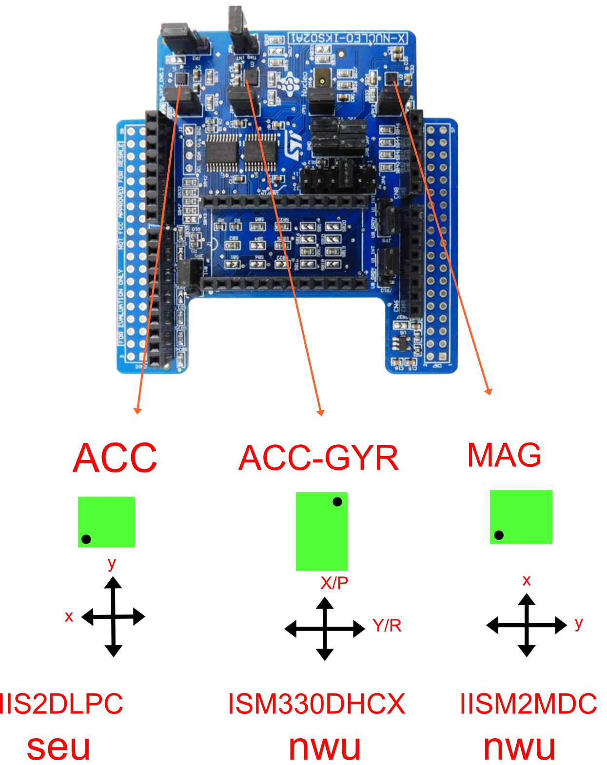

Jul 15, 2025 6:52 AM UTC
I just had to really zoom into the chips, impossible to see letter but  I can see the markings of pin one on the board and the chip, I thought that I had something else to share but my tests so far are not going well as I don't know how to set my reference. The letters NWU and SEU is how I think I need to set them in the MOTIONFX library, but the test are not going good, what I do is Test the Fusion Heading (ism330/iism2mdc) against the raw reading of the Magnetometer in degrees they should be close but so far North is good using NWU/Gyro-Acc and NSU -MAG- the rest is 90degrees off, but I can fix it because I'm guessing.

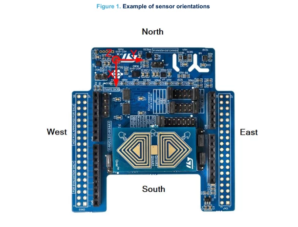

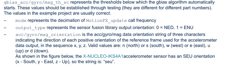

Jul 15, 2025 10:49 AM UTC
For example, the document Getting started with MotionFX sensor fusion library in X-CUBE-MEMS1
expansion for STM32Cube, gives the data for the IKS4 but where is for the rest of the boards? or in this case the IKS02A?
