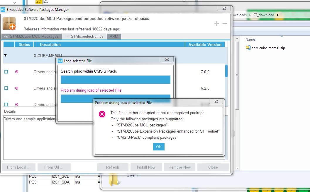

X-CUBE-MEMS1 Drivers installation Error
I want to install X-CUBE-MEMS1 Driver in STM32 Cube IDE(V 1.5). The pc that I use, has not internet connection. I downloaded X-CUBE-MEMS1 Expansion for STM32Cube offline. There is only version 8.2 on ST website. So I chose that one.
I opened Embedded Software Packages Manager window. The last version I can install is vers 7.0 as you see attach file. I continued the installation but I got error.
How can I download version 7.0 or older? Or how can I install version 8.2?
I will glad for your help. Thank you.

if your computer is connected to Internet the STM32CubeIDE should be able to download the list of latest MCU and X-CUBE packages.
Try to press Refresh button in Embedded Software Packages Manager.
Then you can install the packages directly from this window.
