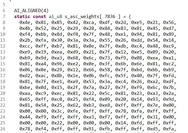

    I face a very similar challenge: the asc_data.c holds the inference matrix, e.g.
    How can I generate an inference that suits the same release used in FP-AI-SENSING1 ?
    I have a two-class model inference.
    Thanks,
    M

    its better to use 3-classes, since the function pack they have used 3 classes-( indoor, outdoor and vehicle).
    Can you tell me what is the duration of the dataset u have used?
    Are you using the same Python script for the model creation which ST use?
    If you want match exactly with the function pack, I think you have to used the same python script by changing the classes.
    Also, use the exact version which they used in function pack.
    Keras---2.2.4
    Tensor flow---1.14.0
    Librosa---0.8.0
    STM32MX CUBE- 5.0
    X-CUBE AI-4.1.0

    Also, its better to use TFlite models to match with the inference matrix.

    Hello Shankari,
    Thanks for your suggestions. I use a dataset of 5-sec-long audio recordings.
    I have used the same Python script available in FP- AI-SENSING1, but I realized a two-class NN.
    Did you ever test Wavelet scattering for audio signals ?
    Regards,
