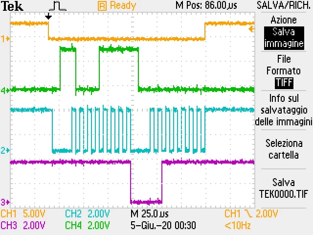

Hi to all.
I correctly set SPI bus as reported on LIS3DSH datasheet:
  • Figure 3. SPI slave timing diagram (page 14)
  • Figure 7. Read and write protocol (page 25)
Here waveforms:

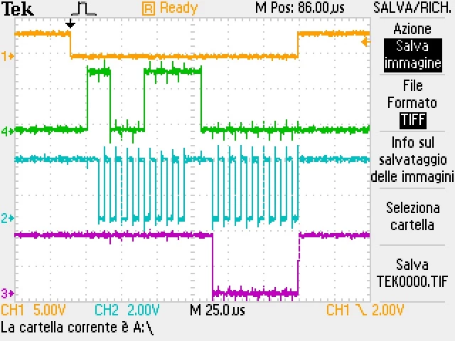

As first operation I detect sensor reading WHO_AM_I register and getting 0 as output value.
I set wrong SPI bus settings (CLOCK idle value low) and it works.
Why?
Yellow = CS
Green = SDI (data to sensor)
Blue = SCK
Red = SDO (data from sensor)
2 replies

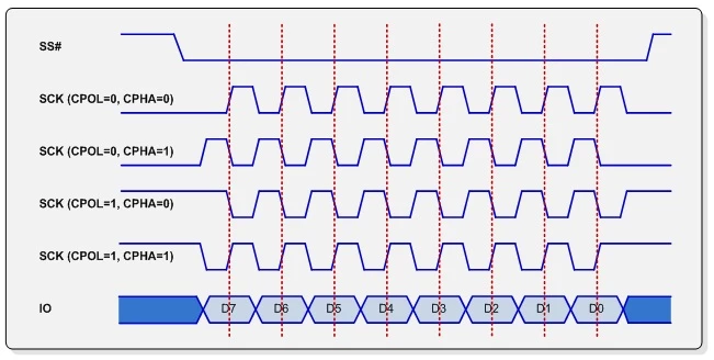

Hi @mbertoni​ , may it be related to the SPI mode timing you have selected at master level for the decoding of the SPI pattern? Regards

You need to set data word size to 16 bit, so you would have constant 16 clock cycles on SCLK line, now you have 8.
