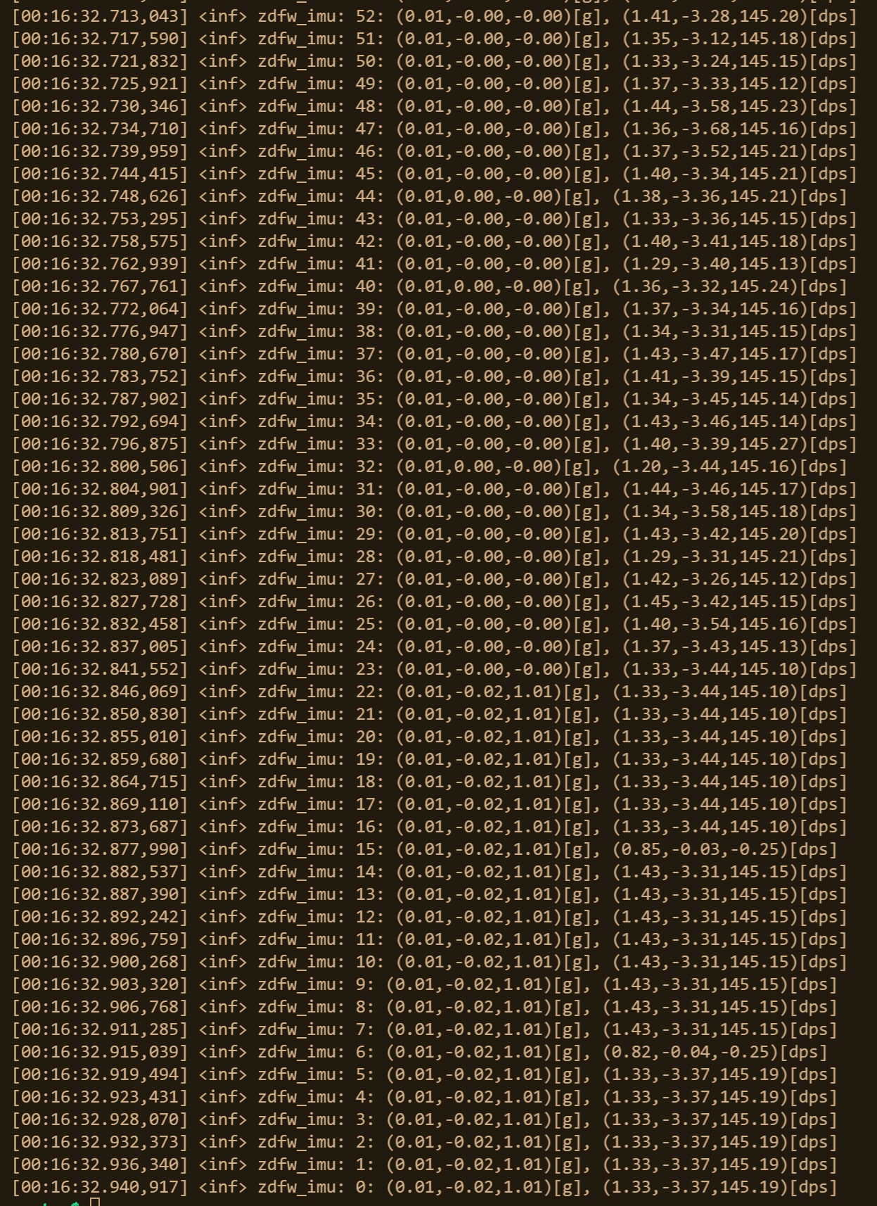

Hi folks,
I am using the LSM6DSO sensor and trying to output data via the pin 2 interrupt. I've set up the interrupt to fire when the FIFO is full to a predetermined threshold. After the FIFO interrupt fires, the system will empty the FIFO of the data and wait for the next interrupt. I've included the following information regarding this issue: code to set up the sensor, code to empty the FIFO, and an example of the incorrect/inaccurate data.

Example of the incorrect/inaccurate data
When the interrupt fires, this is the data I get. The data for (~0, ~0, ~1)[g] is correct to the orientation of the board but the data for (~0, ~0, ~0)[g] is not correct.
Does anyone know what might be causing the (~0, ~0, ~0)[g] data from the FIFO?
P.S. Please let me know if more information is required - I'm more than happy to provide what I can.
