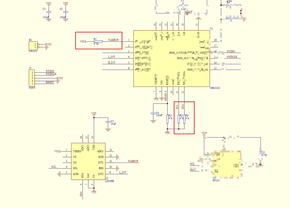

why my lis3dh current consume is bigger than spec?
  • September 10, 2019
  • 1132 views
​1 :
i only use the Lis3dh ,and remove all other elements
2: i use the power 3.0V, i use multimeter test the current consume between VCC and GND
get the test result current is 16 μA,
(the spec says ,the device automatically enters power-down mode, and current is 0.5μA)​
3, then i add the R1,it used for wake up the MCU,and connect to Lis3dh int 1 port ,
then a test the current like before ,but get the current is 56​μA, it is beyond my imagination .
so i want to ask ,is there anything wrong ?why i cannot get the power down mode current consume like spec says ?

who can help me and give me reply ?​
ameeruak
January 8, 2020
Bump.
Seriously this is a really major issue and till now I have been unable to find a proper solution to it......
One solution the guy claims is here but that has not worked for me.
https://forums.adafruit.com/viewtopic.php?f=19&t=107822
I hope someone for ST can step in.
