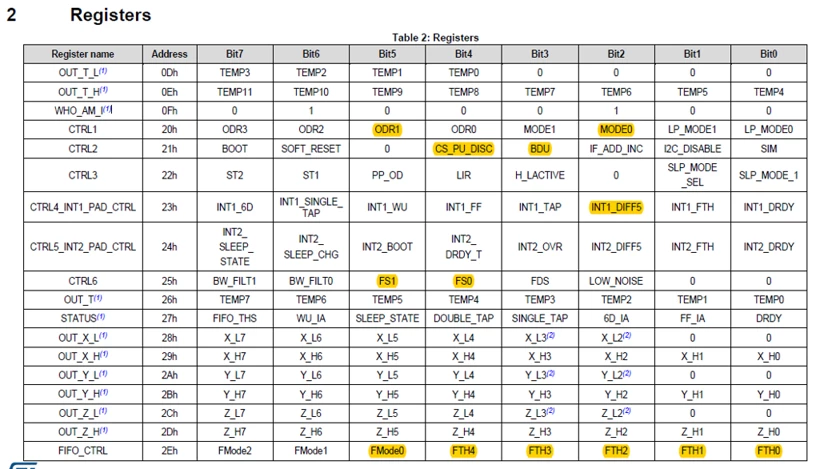

The above setting of register is showing on following table. The yellow mark label is 1.
I also read the registers after setting
LIS2DW12_CTRL1_ADDR
and the result is :
    0x18 (00011000) = LIS2DW12_getRegisterValue(LIS2DW12_CTRL2_ADDR);
    0x04
(00000100)
 = LIS2DW12_getRegisterValue(LIS2DW12_CTRL4_INT1_PAD_ADDR);
    0x30
(00110000)
= LIS2DW12_getRegisterValue(LIS2DW12_CTRL6_ADDR);
    0x3F
(00111111)
= LIS2DW12_getRegisterValue(LIS2DW12_FIFO_CTRL_ADDR);
    0x10 (00010000)= LIS2DW12_getRegisterValue(LIS2DW12_CTRL7_ADDR);
    0x24
(00100100)
= LIS2DW12_getRegisterValue(LIS2DW12_CTRL1_ADDR);

I checked you configuration and it seems to be correct.
In my case the interrupt goes high if the FIFO is full, and it is cleared if read a sample from FIFO or turn off the FIFO.
Can you please try to turn off the FIFO FIFO_CTRL (0x2E) = 0x00 and check the state of INT1 pin?
Are you sure you configured the interrupt in in the microcontroller as input?
