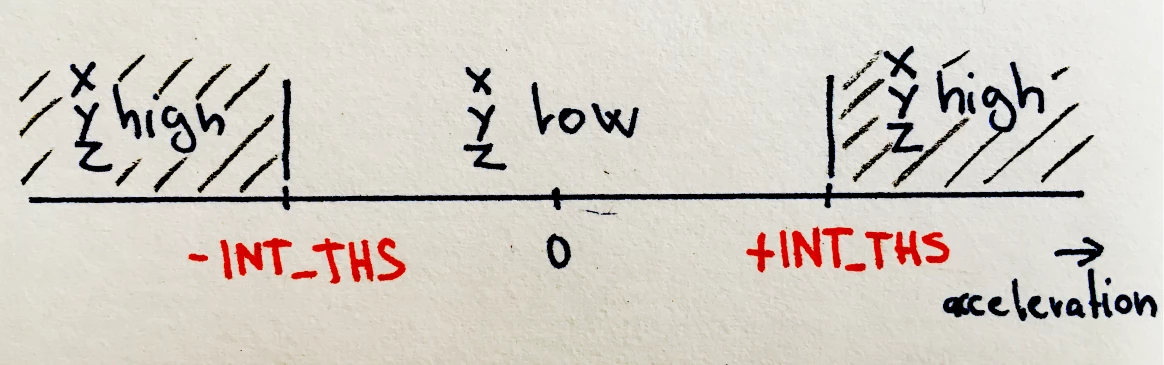

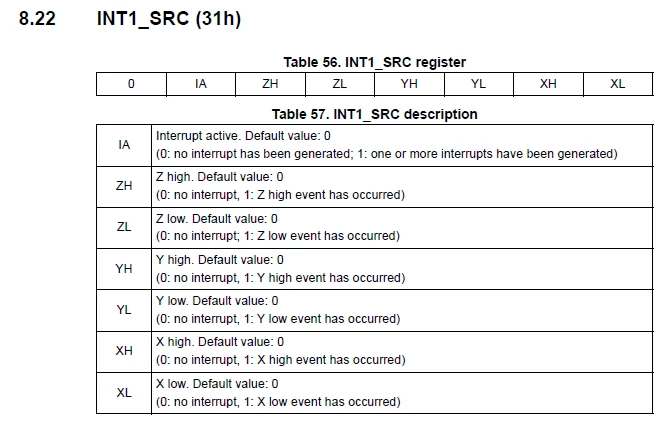

In the INT1_SRC register, there is XH/YH/ZH as well as XL/YL/ZL bits to indicate the (XYZ)H/L event has occurred. But there is only INT1_THS register instead of INT1_THS_HIGH/INT1_THS_LOW. How can I configure two threshold for each axis?

The threshold is common for X, Y, Z axis and it is absolute value. It doesn't matter what sign has the acceleration.

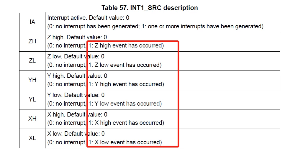

Yes, I understand the threshold is common for XYZ. Probably I have some misunderstanding of those register bits. In the datasheet, it says ZH/L goes 1 when Z high/low event has occurred. What does Z high/low event stand for. What's their relationship with the
INT1_THS
  register  or any other relevant register?

I hope my picture will make it clear.
