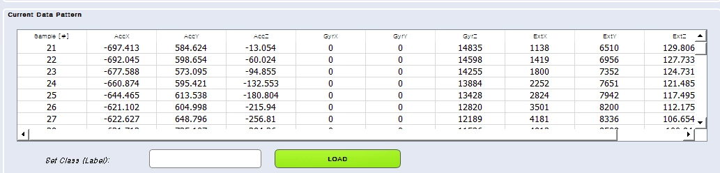

I am using the LSM6DSO32X(in STEVAL-MKI197V1) sensor on the STEVAL-MKI109V3 board.
There is no external sensor.
I see and follow the Datasheet, but the Gyro Data does not come out and the external sensor value comes out.
I used Easy Configuration in the Unico GUI.
No matter how shaking, it doesn't come out.
What is this problem?

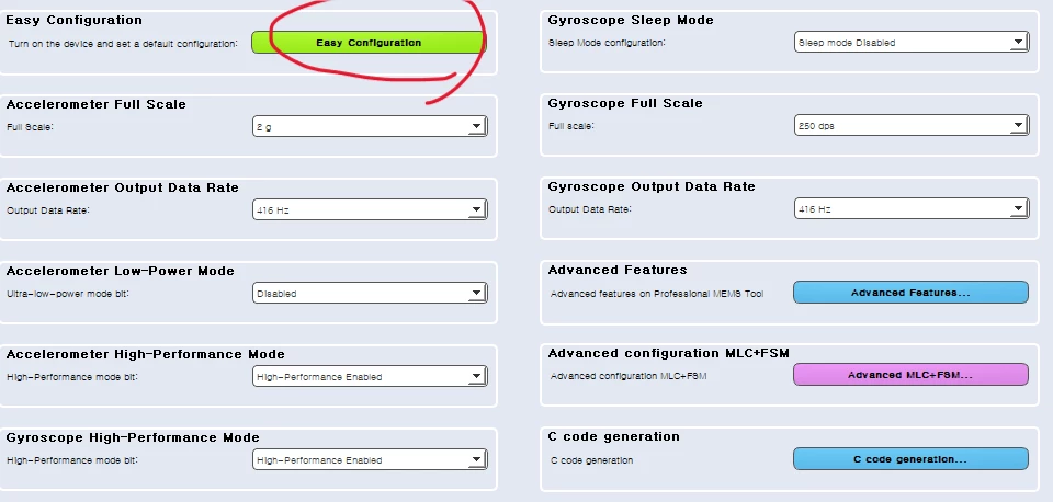

Hi Federica Bossi,
I configurated reg using easy Configuration in the Unico-GUI tool

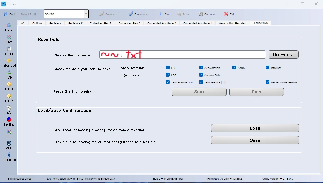

and I started the IMU sensor and started saving data

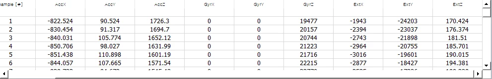

then I loaded the data from the Data Patterns of the MLC Part and this result comes out.
Thank you

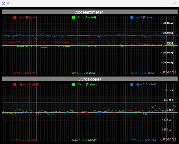

Hi @sygo ,
It seems all correct. Can you try, after the easy configuration, to click on START (on the top, near disconnect) and then plot (on the left) ? Are the gyro outputs plotted?

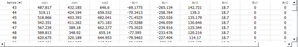

Hi Federica Bossi,
The gyroscope works fine.
Still weird when I save and load again
However, if i just turn up the acceleration, angular rate, and temperature, it comes out fine. Why does it work like this?
