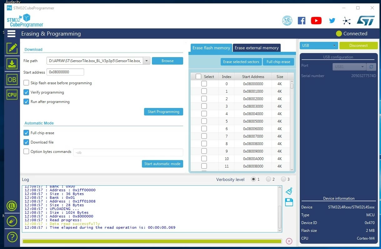

    Many thanks. I have succeeded by using a OnePlus5T yesterday. It was able to download 332 successfully first time over the boot image. What I tried previously was an LG Nexus 4, and all downloads failed. So LD was not very lucky after all! Now that 332 has been installed and run, the LG now works fine, and the LG can download the various demo apps perfectly. Therefore there could be a bug in the original Bootloader firmware. I will try 333 on Monday.

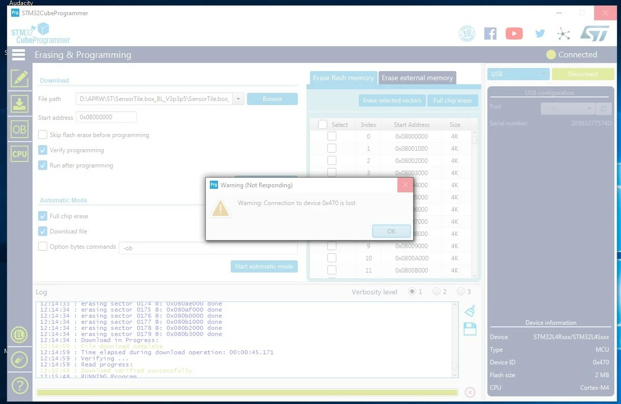

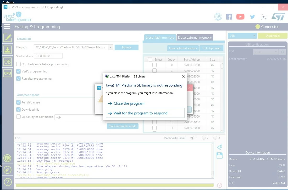

    I have had a long play with 335. Tests335B is a text file with what I have done, so far.
    Programming screen shots, in the wrong order!
    : 0693W000000V040QAC.jpg

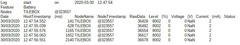

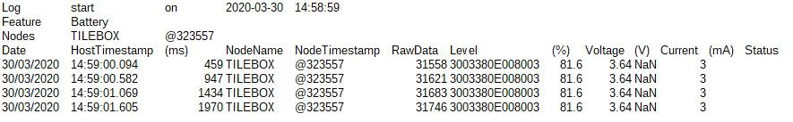

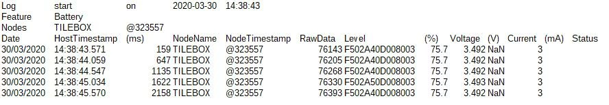

    Battery log files as sent via BT and email....
