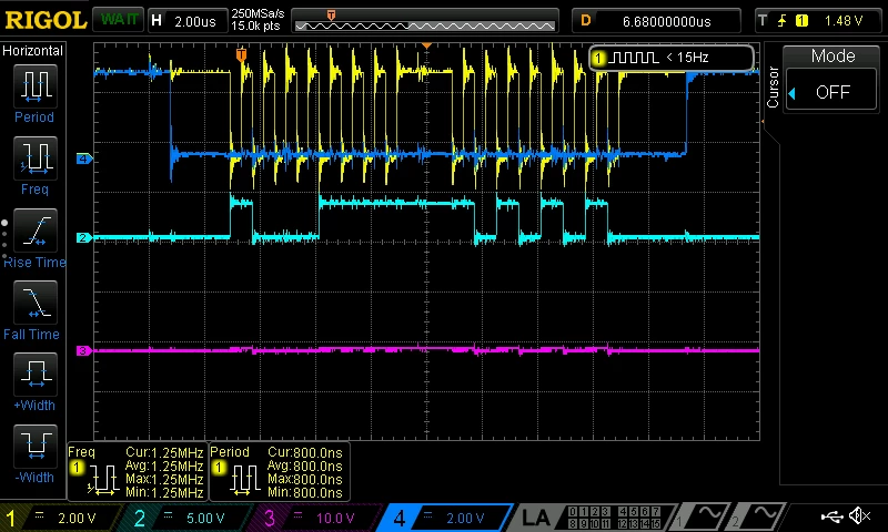

I "think" I have a H3LIS331DL (mounted on its back due to hardware issues with the SAMLC21 based prototype and now fixed with glue). I am aware of the obvious changes in accel directions, but just want to get the prototype running. When reading the WHO_AM_I I get the value of 0b10110010 (and not 0b00110010). I am using SPI at 5MHz, MOSI and MISO look fine with MISO going to high on the falling (9th) SCLK edge in preparation of the first bit being a 1.
A test read of the CTRL_REG1 which powers up to 0b00000111 according to the data sheet gives me the value 0b00000111.
Can it simply be a wrong chip? If so: which one?

    Sounds like a clock phase issue. Should perhaps try bit-banging at low rate to confirm devices reads correctly, and then changing the phase/polarity settings or equivalent on the ATMEL part.

    That, too , was one of my thoughts, but I saw the same behaviour having SCLK being low in idle. Now I have SCLK being high when idling just as the data sheet recommends. No change. A clock phase issue would also more likely cause a complete shift of the byte.
    This picture shows the first clocking of the address 0b10001111 (Read + WHO_AM_I) (CS, MOSI, MISO, SCLK)
    This picture shows the second SCLK when sending out a dummy 0x00 to obtain the register contents.
    The yellow line is the CS, but since it is software driven thei edges are way out left (and right).
    But I havent yet did the bit banging of the signals by hand. Hoped to get away with it :)

    whoops, dont know where the pictures went that included in my first answer! But I just tried writing various values to CTRL_REG1 and reading them back. That works perfectly, so I am thinking that WHO_AM_I simply might be wrong (or I am using a similar chip).
