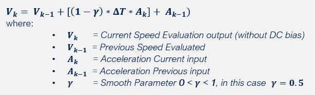

Which techniques are used in IIS3DWB ST's libraries (Motion_SP) to determine velocity(mm/s) from acceleration measurements(g) ? Theoretical foundation from functions "MotionSP_SwSpeedRmsFilter" and "MotionSP_TD_SpeedEvalFromCircBuff".
There is too much uncertainty ? Would be possible to use this measurements to evaluate mechanical vibration according to ISO10816-3 ?

    you can refer to this thread for a precise description of the calculation performed by the MotionSP library.
    In particular, the Speed can be “estimated�? starting from the acceleration values through a numerical integration method.
    One of the most used method is known as TRAPEZOIDAL Rule, and it has been implemented inside the MotionSP.
    The “lambda�? factor is just a parameter fixed to 0.5, giving the opportunity to the user to change. In this way is possible to estimate the speed using a recursive formula as described below.
    Note that every speed value is evaluated using two consecutive acceleration samples, the time sampling (DT = 1/ODR), and the previous speed value.
