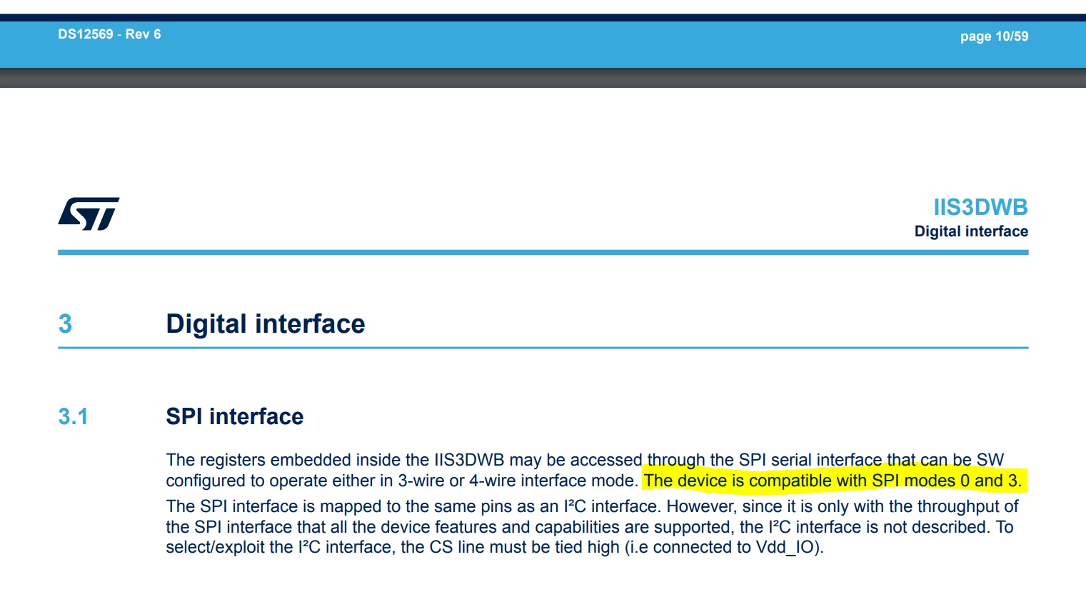

Which SPI mode (CPOL, CPHA values) should one use with IIS3DWB and IIS2DH sensors?
SPI_MODE0 (0, 0)
SPI_MODE1 (0, 1)
SPI_MODE2 (1, 0)
SPI_MODE3 (1, 1)

Sep 9, 2020 12:52 PM UTC
From the datasheet:
The device is compatible with SPI modes 0 and 3.
So CPOL=CHPA=0 or CPOL=CPHA=1.

Sep 9, 2020 1:07 PM UTC
Which datasheet are you referring to?
I could find nothing in either of the two datasheets...
Not sure if I can assume SPI_MODE0.

Sep 9, 2020 1:24 PM UTC
From the first datasheet:
The second device seems to want mode 3 only, or at least doesn't specify.

Sep 9, 2020 1:33 PM UTC
Ahah! Yes, was looking at the wrong revision of the datasheet. Rev 5 does not contain SPI mode...
Thank you!
