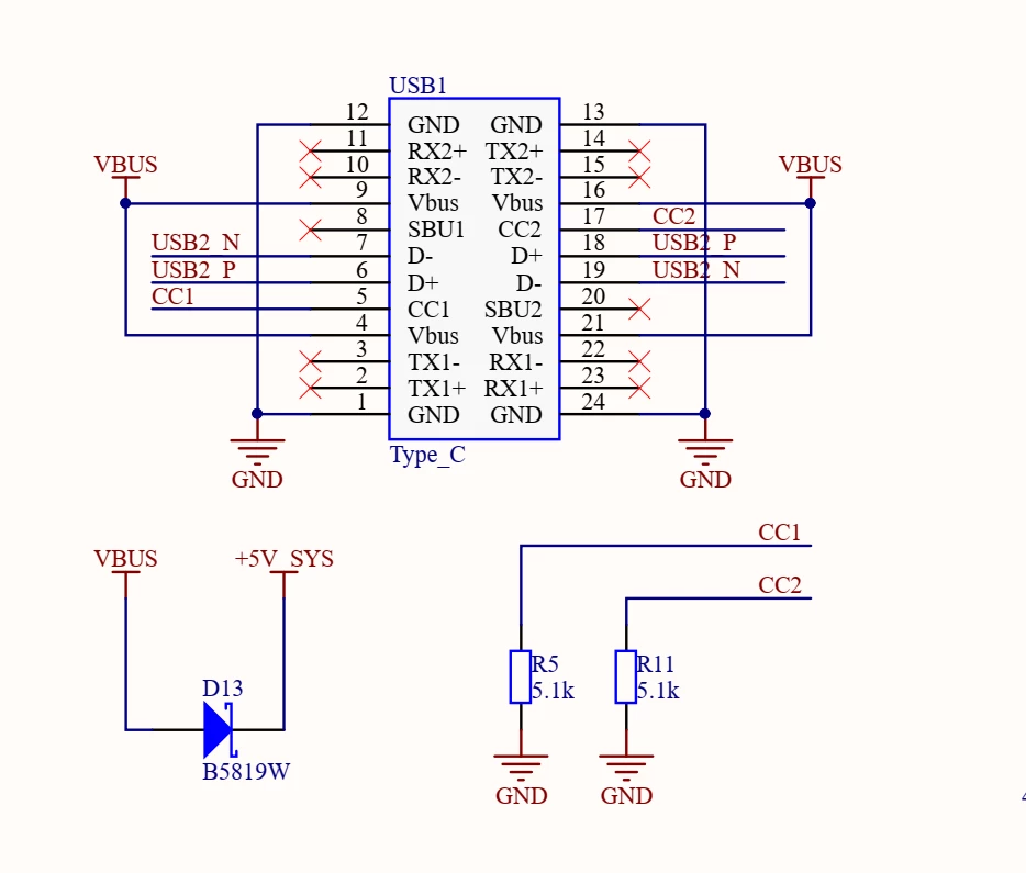

whether the USB of the STM32MP1XX must use USB-OTG mode?
  • October 11, 2023
  • 0 replies
  • 1041 views
Use the cubeProgram tool to burn the MPU, whether the USB of the MPU must use USB-OTG mode?
