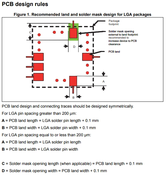

Where can I find the land pattern for H3LIS331DL?

Hi @KA.2​ , you can refer to the technical note TN0018 at p. 5 (you can find it in the Resources page of H3LIS331DL). Regards
