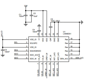

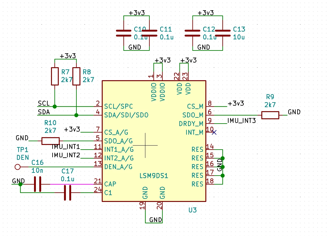

what's voltage on Pin21(CAP) and Pin24(C1) on LSM9DS1 after power-up?
on my board, the voltage on Pin21/ 24 are ~ 0.002v after power-up, it that correct ?
here is my schema:0693W000004JKeoQAG.png
Thank you very much!

Hi @MMa.1893​ ,
The schematic is correct and the voltage value you see on CAP and C1 pins are ok.
For completeness, you can compare your scheme with the one of the LSM9DS1 adapter STEVAL-MKI159V1, shown here below:
-Eleon

Hi @MMa.1893​ ,
Can you please confirm us that your circuit is working well?
-Eleon
MMa.1893
MMa.1893Author
November 2, 2020
ok, my circuit is correct..
the chip works now.
