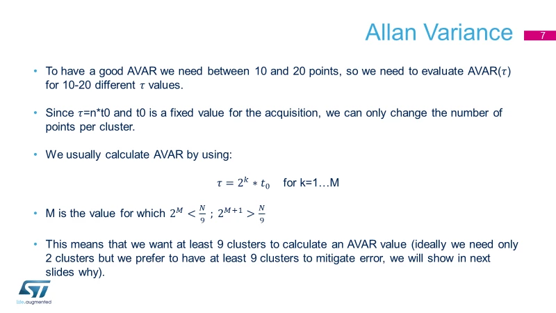

What's the usual measurement time/data points required to do allan variance on an IMU sensor?

May 27, 2022 1:33 PM UTC
Hi @KJ.2ose​ ,
I can share you our prescription in terms of Allan variance calculation:
0693W00000NqmAZQAZ.pngThis should help you about the calculation for the Allan variance.
