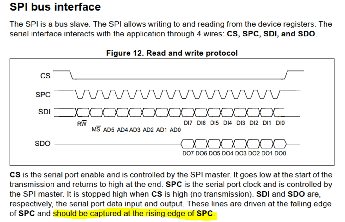

What is the SPI mode of the gyroscope sensor I3G4250D?
I use the KIT STM32F411 Discovery
When I choose:
SPI CPOL: Low
SPI CPHA: 1 Edge
It works
But when I choose:
SPI CPOL: High
SPI CPHA: 2 Edge
It does not work
Could you explain why? Thank you!

Aug 16, 2025 1:20 PM UTC
> SPI CPOL: High
> SPI CPHA: 2 Edge
These are the correct settings. If it doesn't work, there's probably a bug in your code.
Ensure SPI peripheral is active before you assert CS. Send a dummy transfer without CS active in order to ensure this.

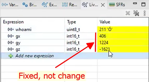

Aug 18, 2025 4:01 PM UTC
Hi
What does L3GD20_Read_WHOAMI return?
--> It returns 211
When I use
 > hspi1.Init.CLKPolarity = SPI_POLARITY_HIGH;
> hspi1.Init.CLKPhase = SPI_PHASE_2EDGE;
The sensor returns only 1 time (then the sensor data does not change anymore)
Do you know the reason why?
Thank you

Aug 21, 2025 4:21 PM UTC
"Try doing a dummy SPI transfer (with CS high) prior to your first SPI transaction, but after SPI is initialized."
-->Wowww. It works. Thank you very much. Could you explain why?
Aug 21, 2025 6:17 PM UTC
The CLK pin is not driven until the peripheral is enabled. On the first transaction, it's low when you set CS low, which messes up the first transfer. Doing a dummy transfer enables the peripheral. See my first reply.
