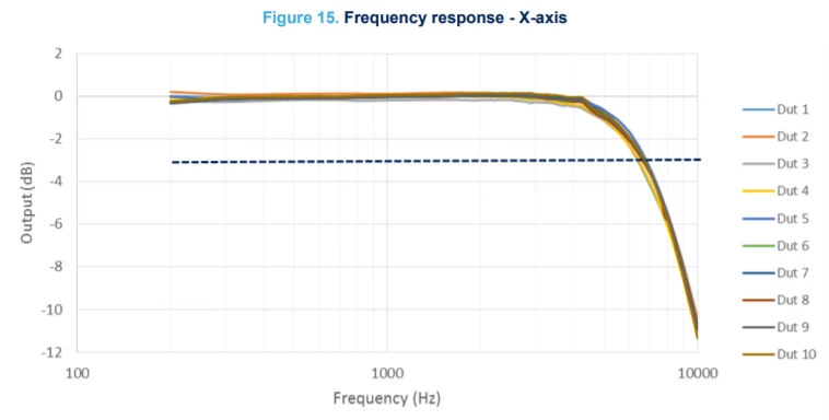

what is the sampling frequency in each axis for IIS3dwb digital accelerometer sensor
  • September 1, 2021
  • 3 replies
  • 1320 views
I see that ODR mentioned in datasheet is 26.7Khz but my doubt is that whether it is in each direction (x,y,z) or combined for all 3 axis. This is because when i try to measure the time taken to take samples then i get it around 9000Hz in each direction. I am using data polling technique via STM32 F4 controller
If it is so then how BW of 6.3Khz is achieved
Best answer by Eleon BORLINI
Hi @ASriv.3​ ,
the 26.7kHz ODR is for all the 3 axis, in the sense that you will receive a batch of (X,Y,Z) every 1/ODR, meaning in first approximation the .
You can configure the single axis mode so that you can get 26.7kHz on the single axis.
XL_AXIS_SEL[1:0] = xxb (00 = 3 axes; 01 = X-axis; 10 = Y-axis ; 11 = Z-axis)
The 6.3kHz bandwidth refers mostly to the frequency response flatness (±3 dB point) of the mechanical element, as you can see from the Figure 15., 16., 17. of the datasheet.
0693W00000Dm11hQAB.pngThis means that the device can detect a vibration up to 6.3kHz without loss in sensitivity.

So in case we take samples on single axis it should be 26.7K right?
But i tried to calculate using HAL_gettick() in STM where i was getting around 13k . Is this because we read 2 registers H and L for getting the samples.
Please confirm that Sampling freq is 26.7 KHz in one direction and if we are taking on all 3 axis then it is approx 26.7/3 Khz

Hi @ASriv.3​ ,
Right, this should be the case, not 13kHz.
So that's strange you get only this value. In any case, it is enough by Nyquist to exploit all the sensor band, which is 6.3kHz.
Yes, this is correct.
