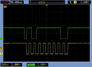

hello,why in my project, I have not receive the ack sigal when i send an 0xBE to write the command. the problem just like the picture.
January 3, 2018
Posted on January 03, 2018 at 10:49
It seems there is an HW issue, can please check the power supply is connected, CS is high and both I2C pins (SCL, SDA) are really connected to microcontroller.
