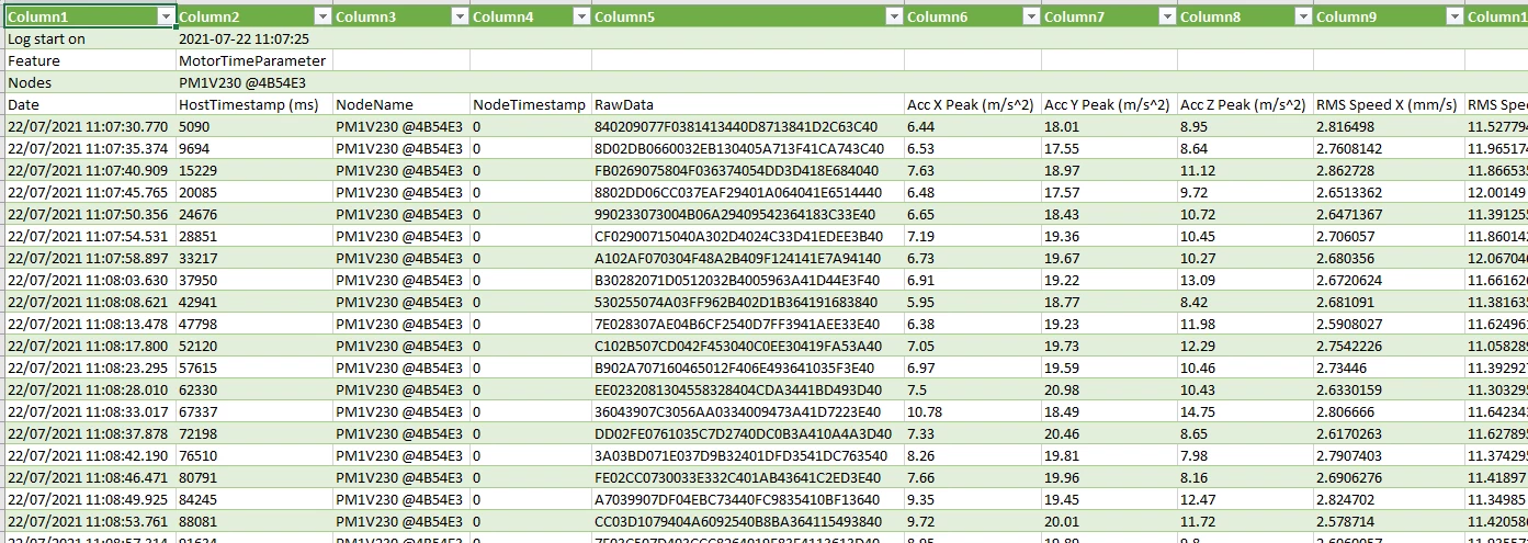

What is the flow chart to get the Acc X Peak/Acc Y Peak/Acc Z Peak in ST BLE App?
Hi , I am using ism330dhcx vibration sensor to measure vibration acceleration on motor. The sensor outputs LSB to MCU, then MCU used it to calculate the actual acceleration in mg (LSB * sensitivity). What is the simple flow chart to get the Acc X Peak/Acc Y Peak/Acc Z Peak? By average acceleration data or something else? Please advise. Thanks!

    So far, you can consider the values as the output of the MotionSP library: the acceleration peak data are averaged in a window defined by tau and lambda, as described theoretically in this whitepaper.
