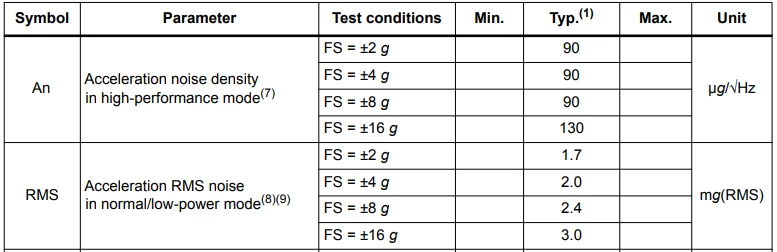

What is the difference between the low-power mode and the high-performance mode of LSM6DS3TR-C, if I only operate the accelerometor at 12.5Hz.

    Hi @Community member​ ,
    Let's assume you are in this condition:
    0693W00000Ly49kQAB.pngThe two main parameter varying with the performance are the noise (decreasing) and the current consumption (increasing). You have to evaluate this trade-off according to your application requirements. You can find more details in the LSM6DS3TR-C datasheet.
    -Eleon

    Hi, @Eleon BORLINI​
    Thank you very much for helping me clear my concerns.
    Sorry that I didn't notice that the difference is written in the "Mechanical characteristics" table
