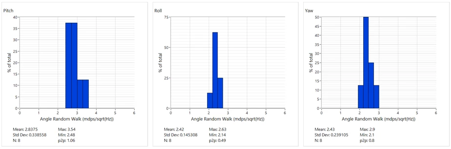

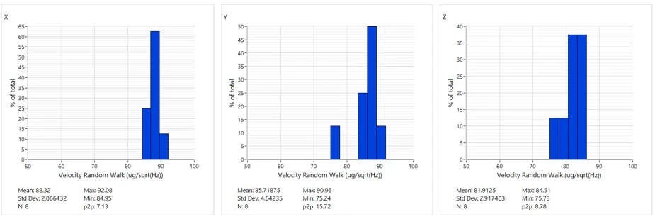

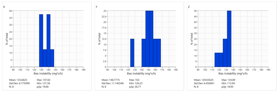

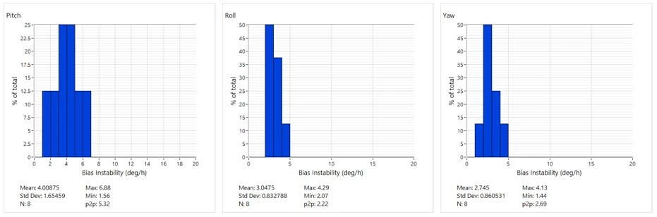

What is the bias in-run stability / instability of the LSM6DSR gyros and accelerometers?

Hi @WJohn.1​ ,
Since these two AVAR parameters (the bias stability and bias instability) are not tested at production level, I can share you some characterization results on a limited set of data:
  • Accelerometer, Velocity random walk (Bias stability)
  • Accelerometer, Bias instability
  • Gyroscope, Angle walk (Bias stability)
  • Gyroscope, Bias instability
-Eleon

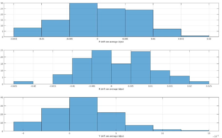

Thank you for sharing this.
Any chance you have gyro vibration rejection data for this part?

Hi @Singh.Harjit​ ,
Can you please specify your application?
I can only share you the LSM6DSR Gyro drift related to the below Sinusoidal wave input test on shaker. Gyro ODR is 208Hz.
  • Amplitude: 4 g
  • Frequency: 100 Hz
The number of tested devices is 22.
0693W000006HswMQAS.pngPlease let me know if these info can help you.
-Eleon

Thank you for sharing. This actually looks really good.
The application is robotics / drone. I'd love to see this over a larger frequency range but I understand you all may not be setup for it.
