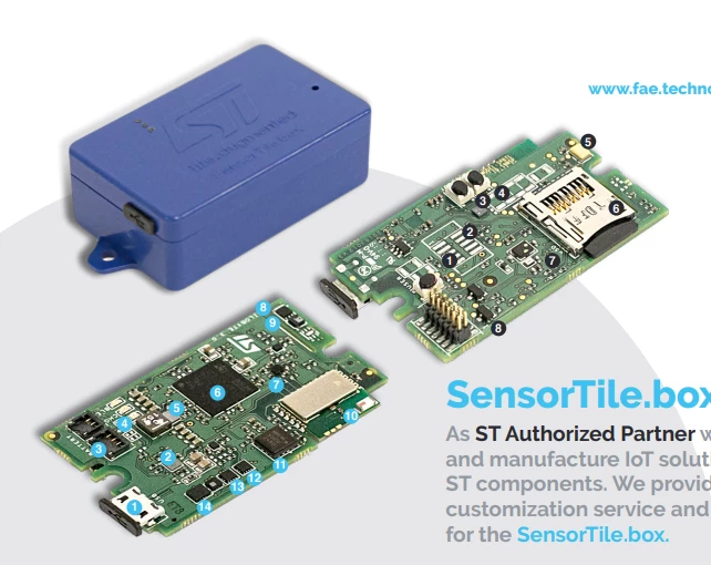

Here is the back side of the board.
Please look at the attached image thank you

No picture attached. Make sure you upload and insert it.
Eugene Agustin
Jul 12, 2019 12:50 AM UTC
Sorry I forgot to insert.
Thank you

Hi @Eugene Agustin​ , if programming through JTAG/serial wire debugging (SWD), I suggest you to use the ST-LINK/V2 programmer because of 1.8V level compatibility with ,ow power STM32L4R9. The HW connection is the connector numbered "8". Board schematic will be available soon on st.com. Regards

Hi @Eugene Agustin​ , please consider this note, as reported in the SensorTile.box user manual:
>> Note: Your ST-LINK must have the level shifter to function at 1.8 V (the SensorTile.box power supply).
This mean that you should use by now either the STLINK V2 which is 1.8V compatible or the STLINK V3 with level shifters from 3.3V to 1.8V. If you already have a Nucleo board, you can use the onboard JTAG programmer (which is a STLINK V2). However, please consider that an adapter board from STLINK V3 to SensorTile.box will be soon available online.
Another way to program the SensorTile.box is through the dfu mode: you can build your FW and generate the .dfu file, which can be downloaded on the SensorTile.box through the DfuSe. Not the best way to do a debug but it should be only a temporary patch.
