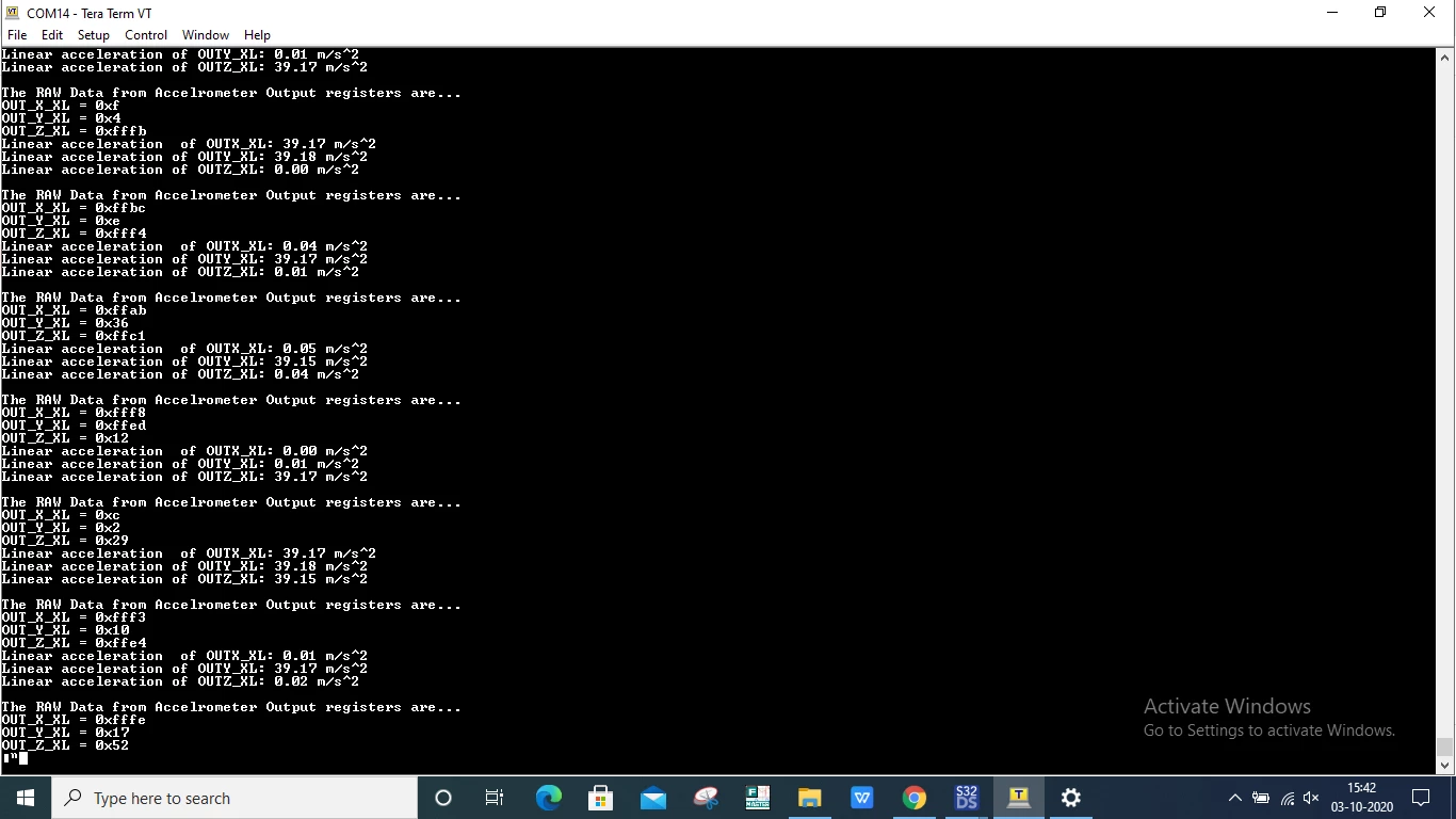

Hi Eloen,
We are Still facing issue in getting the correct data from the sensor.
The registers we are setting is
Register               Data
CTRL_REG5_XL (0X1F) - 0x38
CTRL_REG7_XL (0X21) - 0xA5
CTRL_REG9    (0X23) - 0x02
FIFO_CTRL     (0X2E) - 0xc0
CTRL_REG10   (0x24) - 0x01
CTRL_REG8    (0x22) - 0x04
CTRL_REG6_XL (0x20) - 0x47
After setting these registers we are reading the data registers and calculating the values. I have attached the code snippet for calculation and output screenshot.
In the output the values of x,y,z keep on changing.
We can't figure it out, can you please tell us what we are missing.

PFA of the attached output logs of Accelerometer.

it looks like data are multiplied by a factor of 4.. are you sure you did the two's complement and in general the LSB to physical units data conversion in the right way?
float_t lsm9ds1_from_fs2g_to_mg(int16_t lsb)
 return ((float_t)lsb *0.061f);
I'm referring to this part of your code:
 acc_x_data = (~OUT_X_XL);
 acc_x_data += 1;
-Eleon
