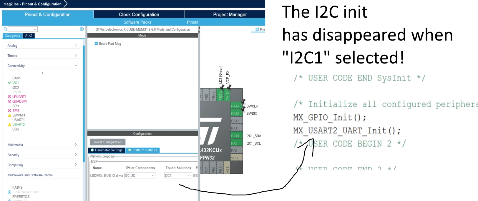

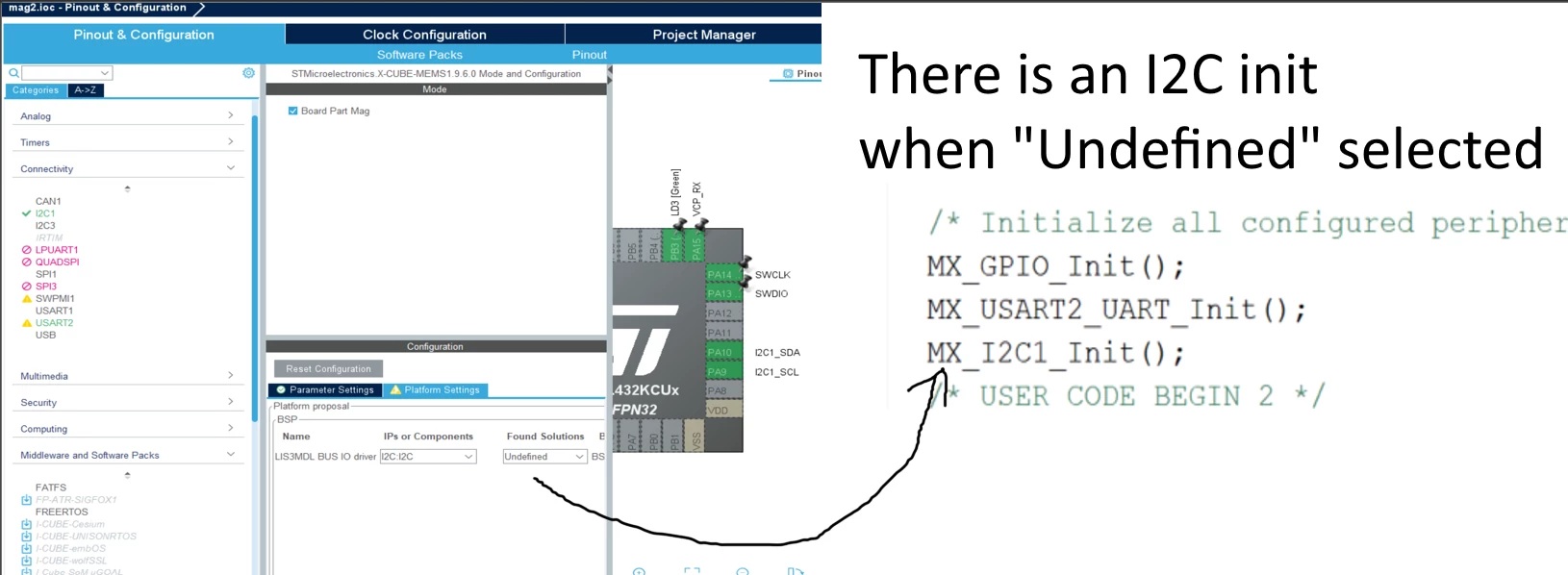

Upon generating the code, I came across a problem where
MX_I2C1_Init();
was disappearing from the generated
main.c
file when I selected "I2C1" under "Middleware and Software Packs" in the "Found Solutions" tab. However, if I left it as "Undefined", the
MX_I2C1_Init();
would be included in the generated code. This issue is obstructing my progress with the sensor setup and I'm looking for help to troubleshoot and resolve this.

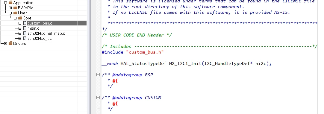

Hello @DLid.1​ ,
when you use the CMSIS pack of the MEMS, You can find the Initialization of the MX_I2C1_init(); in the custom_bus.c file not in the main.c.
