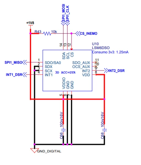

Hi Ravi @RShiv.1​ ,
Currently, the free fall detection (a bit different from a man-down application, but "yes" to question 2) is implemented at firmware level, not exploiting the embedded feature of the LSM6DSOX.
>> How to calculate or get fall detection?
In this video, it is described how to implement the free fall detection via the STBLE sensor smartphone application.
You can just set the threshold above which the free-fall is defined (in the example, 200 milli-g) and you'll receive a notification every times this threshold is crossed.
If you want to implement the free-fall at firmware level, you can start from the FP-SNS-STBOX1 examples.
If otherwise you want to exploit the embedded feature of the LSM6DSOX for the free fall detection as explained in the app note AN5272, p.42, you can exploit the INT1_DSR and INT2_DSR pins from the schematic:

Eleon BORLINI
October 26, 2021
Hi Ravi @RShiv.1​ ,
If you want to use the Sensortile.box as a free fall detection tool using the the LSM6DSOX, I suggest you to start from an existing FW, configure the LSM6DSOX for the free fall detection and then enable a LED (for example the green one).
You can do it as described in the previously linked video.
You don't need to run the MLC, in principle.
However, if you are interested in a more complex pattern recognition (such as a particular man-down), you might need to set up a more complex configuration.
In this case, on the BLEMLC section (p.17 of the user manual UM2626), and from slide 280 of this presentation you can find more information for a starting point.
-Eleon
