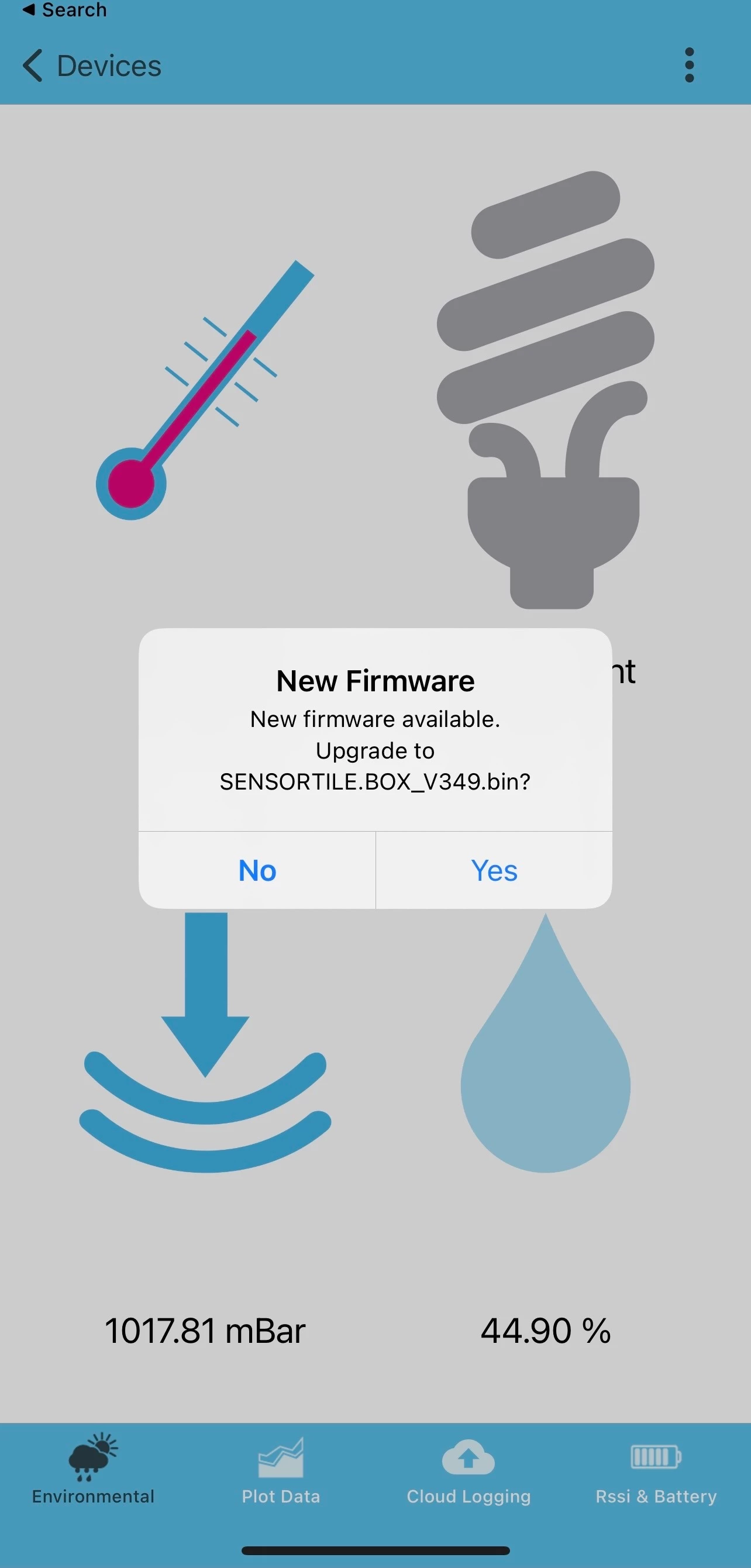

was there a bug in the last OTA software update? the board is completely dead. how to restore the board?
we have a sensortile that I connected to via the sensor ios app. got a pop up in the app that there's a new firmware available. and pressed ok. following that, the board did not come live. the same thing happened on a second board.

    this is the firmware that crashed now 3rd sensortile.box immediately after the update. 0693W00000FBhHbQAL.jpg

    Hi @HAbdo.1​ ,
    please check this post that explains you how to restore the Sensortile.box in case of this kind of issues.
    I attach here the last FW version with the bootloader, so that the APK will not ask you the upgrade any more.
