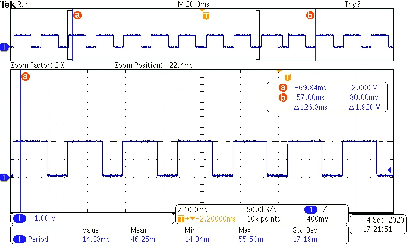

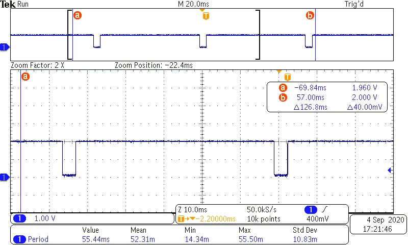

I am using a PNUCLEO VL6180X and I would like to drive my LED from the GPIO1 interrupt output only this output as shown in the diagrams above is always at 1 and it goes to 0 only for a few nanoseconds; I would like to have an interrupt signal only when I bring my hand closer to the sensor, I would like it to send a 1 to the LED when there is a target and a 0 when there is nothing.
Here are some images on the oscilloscope with the target and without the target

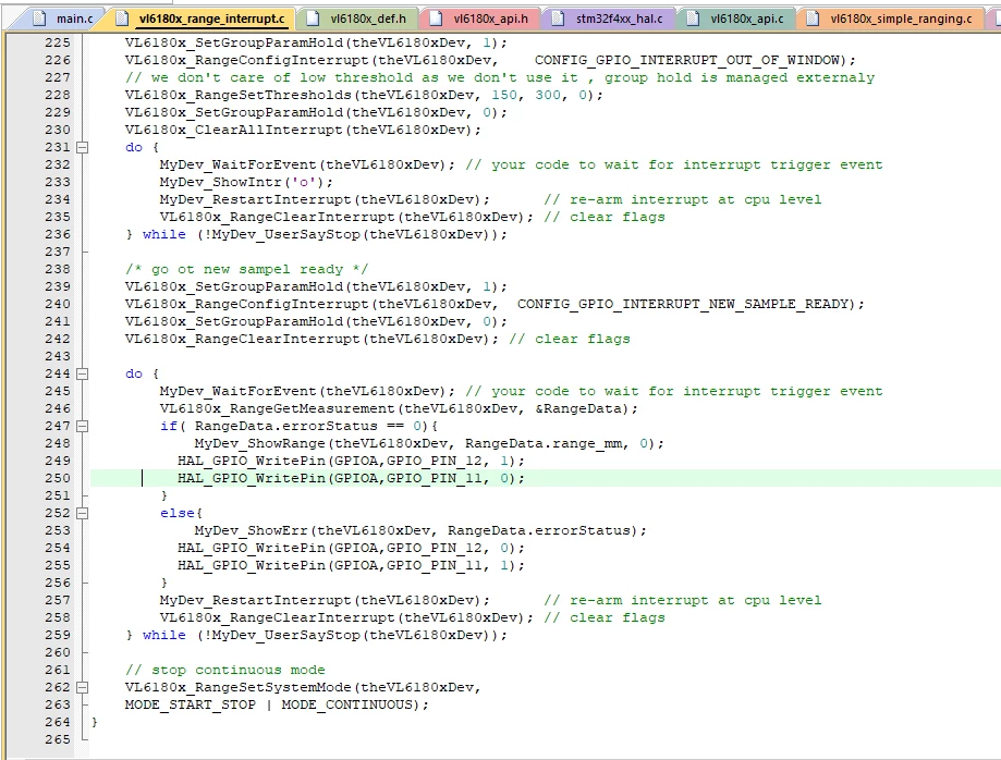

I've another questions :
In my main program, I'm calling the Sample_Ranging () functions to perform the measurement and the Sample_Interrupt () function to generate the interrupt but when I just call the sample_interrupt, I don't have a distance display in mm although with the new sample ready I have a show range.. How do you explain that ?
The other thing is if I want to add a new GPIO port from the mcu in which wait loop should I add the line of code to do it?

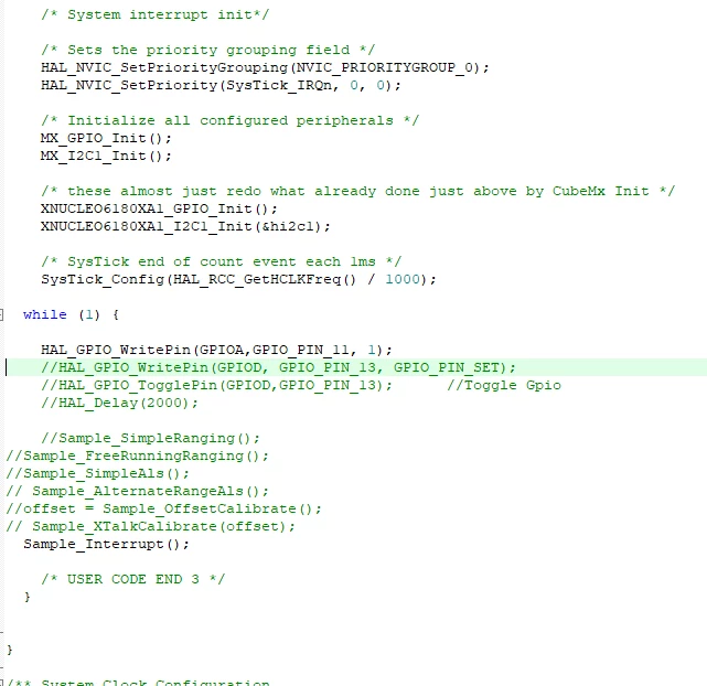

0693W000004GLIYQA4.png0693W000004GLIJQA4.pngHello @Eleon BORLINI​
Yes I've found the solution thanks evryone for helping me.
I sent you an example of my main code and my interrupt code. I've just take another pin of the MCU to command the LED it was very simple when my MCU detect the interruption my LED blink but I've add another LED who should take on when no target is detected and off when target is detected. Sorry for my english i'm french.
In the bottom you will see the code. Thank you
