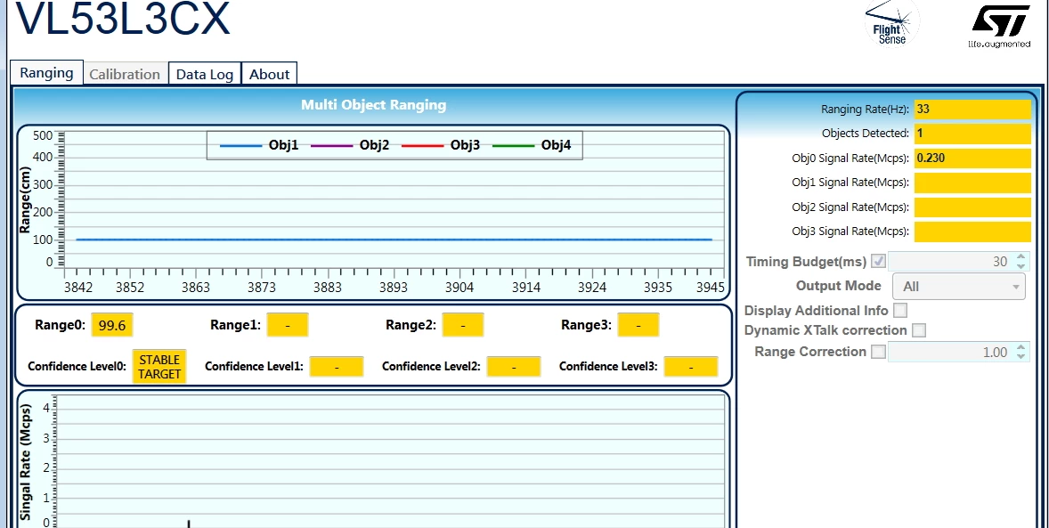

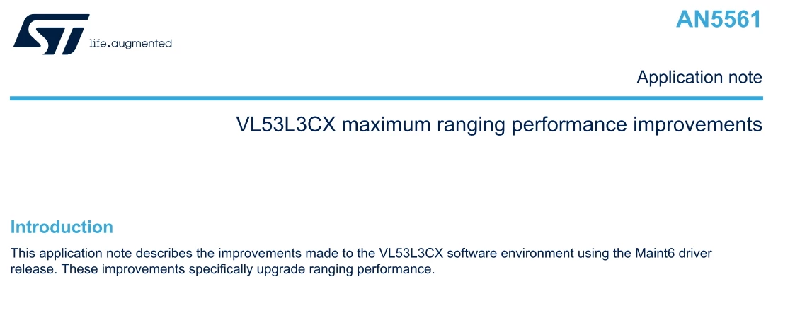

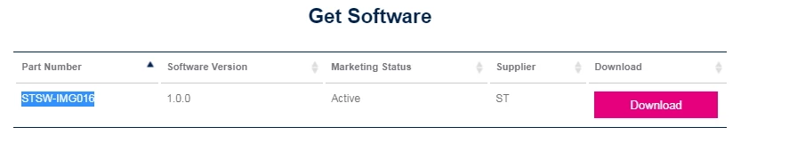

I downloaded the 53l3 GUI sw from ST website here PN is STSW-IMG016 . Does it include Maint6 driver ? (It from AN5561 application note)
https://my.st.com/content/my_st_com/en/products/embedded-software/proximity-sensors-software/stsw-img016.html#get-software
Pls check picture 1.jpg & 2.jpg.

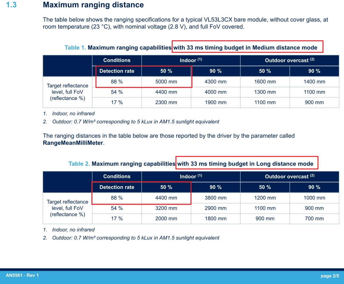

If STSW-IMG016 GUI SW can allow 53l3cx If STSW-IMG016 GUI SW can allow 53l3cx to measure the maximum distance of 5 meters
How to switch between medium (indoor, 5000mm /50%/ 88% white card) & long mode (indoor, 4400mm /50%/ 88% white card )

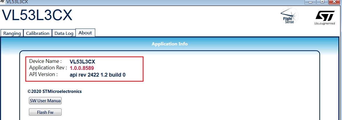

0693W000007ZQOqQAO.jpg0693W000007ZQP0QAO.jpgPlease 5.jpg, It's my GUI SW using version info, does it incloud maint6 driver ? & can it make 53L3cx bare module to measure to 5m distance ?0693W000007ZQVwQAO.jpg

The VL53L3CX includes all the improvements in Maint 6. That's how the distance can get to 5M in the best case setup.
If everything is perfect - No 940nm ambient light, and a big, very reflective target - you can get to 5M.
