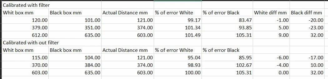

I have been experimenting with the X-NUCLEO-53L3A2 and have grabbed some quick measurements to see what the accuracy looks like. I am using it the range of 100mm-1000mm indoors. I have callibrated it using a white box with white computer paper taped to it for the offset and a random dark black box for the cross-talk. Using those same object I have measured the following:
My question is, are there any ways to improve the accuracy?
