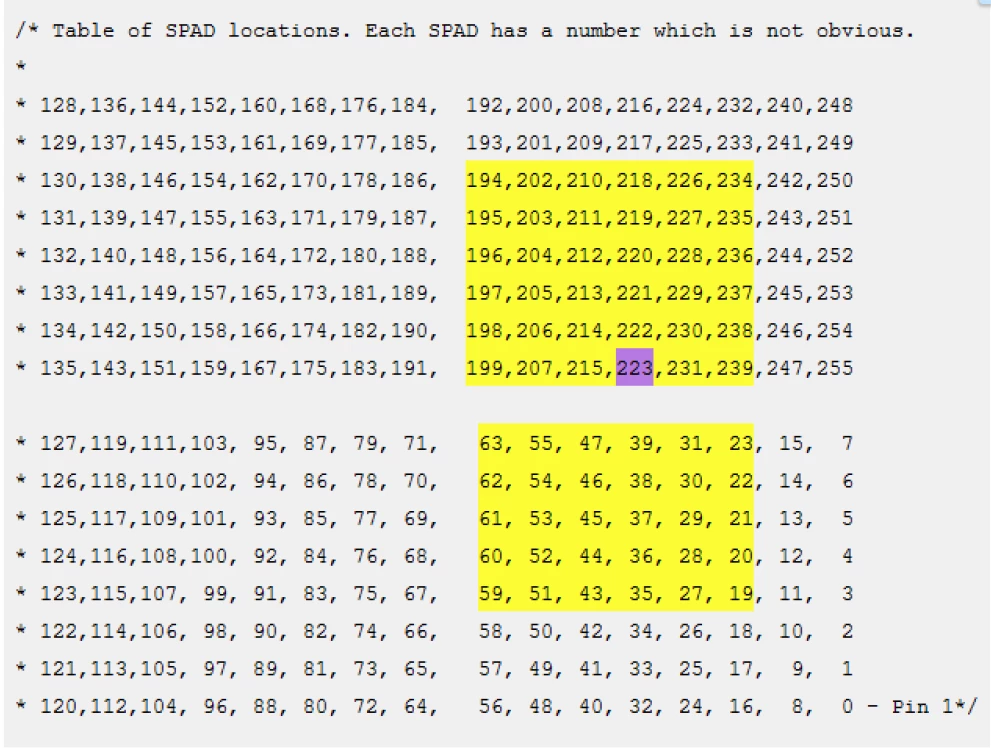

But if I replace those values with the values from document UM2555 VL53L1X ultra lite driver multiple zone implementation example, I get all the time:
  • RangeStatus = 2 (VL53L1_RANGESTATUS_SIGNAL_FAIL)
  • Distance = values too high.
 status_ST += VL53L1X_SetROI(I2C_ADDRESS_29, 6, 11);
 status_ST += VL53L1X_SetROICenter(I2C_ADDRESS_29, 223);
The document's example is:0693W000004H7yhQAC.png
Why is this happening?

John E KVAM
Sep 25, 2020 2:09 PM UTC
One unfortunate effect of disabling over half the detectors as you did was to cut down the distance the device can 'see'. One can a see a large, reasonably reflective target at 4M. But if you disable over half that SPADs the detection distance would go way down. I'm would generally guess that is your issue.
But you say that you cannot see an object at 20cm? That should not be an issue, unless your object was exceptionally black or there was sunlight involved.
Can you use the Evaluation Kit to simulate your experiment. Then you can use the logging function to see all the data. There might be some hint in there.
Or you could ask for the VL53L1X_GetAmbient() and see if extra ambient is too high.
One other approach is to increase the size of the ROI, and see at what point you see what you need to see. And can you live with that.
Or you can take a sheet of white paper and carefully cross over the sensor. Decide at what angles you are looking. And use it to find your max range.
Knowing where the 'top' is in your diagram is not as easy as you would think.
Then try the same experiment with your hand. (Paper is 88% reflective, Hands are 40-61% reflective.)
Also, increase your timing budget if you can. That helps to find things when the signal is too low.
I use a full half and I can see people walking under a 10 foot tall door. So that's a range of 4 feet or so.
