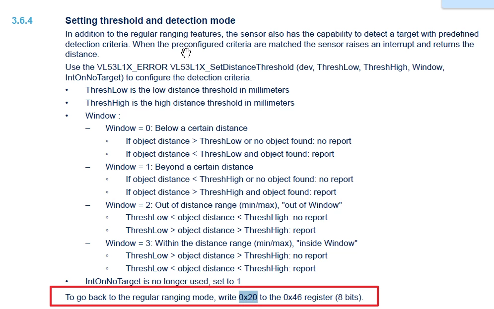

    Until now, when I wanted to measure continuously ingnoring thresholds, I wrote value 0x20 to register 0x0046 (SYSTEM__INTERRUPT_CONFIG_GPIO), as ULD manual says:
    However my problem persists: I want to use window thresholds and interrupt GPIO pin. And I want to store the distance values measured by VL53L1X.
    The problem is that the sensor ONLY returns distance values when the target is within window thresholds. When the target is outside that thresholds, the sensor DOESN'T RETURN any value.
    Is it possible to get distance values when target is outside window thresholds?

    You are using the ULD - UltraLite Driver.
    So the threshold code looks like:
    VL53L1X_ERROR VL53L1X_SetDistanceThreshold(uint16_t dev, uint16_t ThreshLow,
    			 uint16_t ThreshHigh, uint8_t Window,
    			 uint8_t IntOnNoTarget)
    	VL53L1X_ERROR status = 0;
    	uint8_t Temp = 0;
    	status = VL53L1_RdByte(dev, SYSTEM__INTERRUPT_CONFIG_GPIO, &Temp);
    	Temp = Temp & 0x47;
    	if (IntOnNoTarget == 0) {
    		status = VL53L1_WrByte(dev, SYSTEM__INTERRUPT_CONFIG_GPIO,
    			 (Temp | (Window & 0x07)));
    	} else {
    			 ((Temp | (Window & 0x07)) | 0x40));
    	status = VL53L1_WrWord(dev, SYSTEM__THRESH_HIGH, ThreshHigh);
    	status = VL53L1_WrWord(dev, SYSTEM__THRESH_LOW, ThreshLow);
    	return status;
    And indeed
    #define SYSTEM__INTERRUPT_CONFIG_GPIO 0x0046
    So the manual and the function at least agree on the register to be messed with.
    You state:
    "The problem is that the sensor ONLY returns distance values when the target is within window thresholds. When the target is outside that thresholds, the sensor DOESN'T RETURN any value."
    Looks to me like you need to mess with the parameter - IntOnNoTarget, That reverses when you get the interrupt. IN or OUT of the min/max you have set up.
