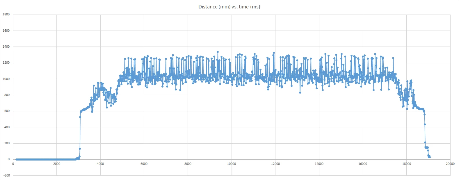

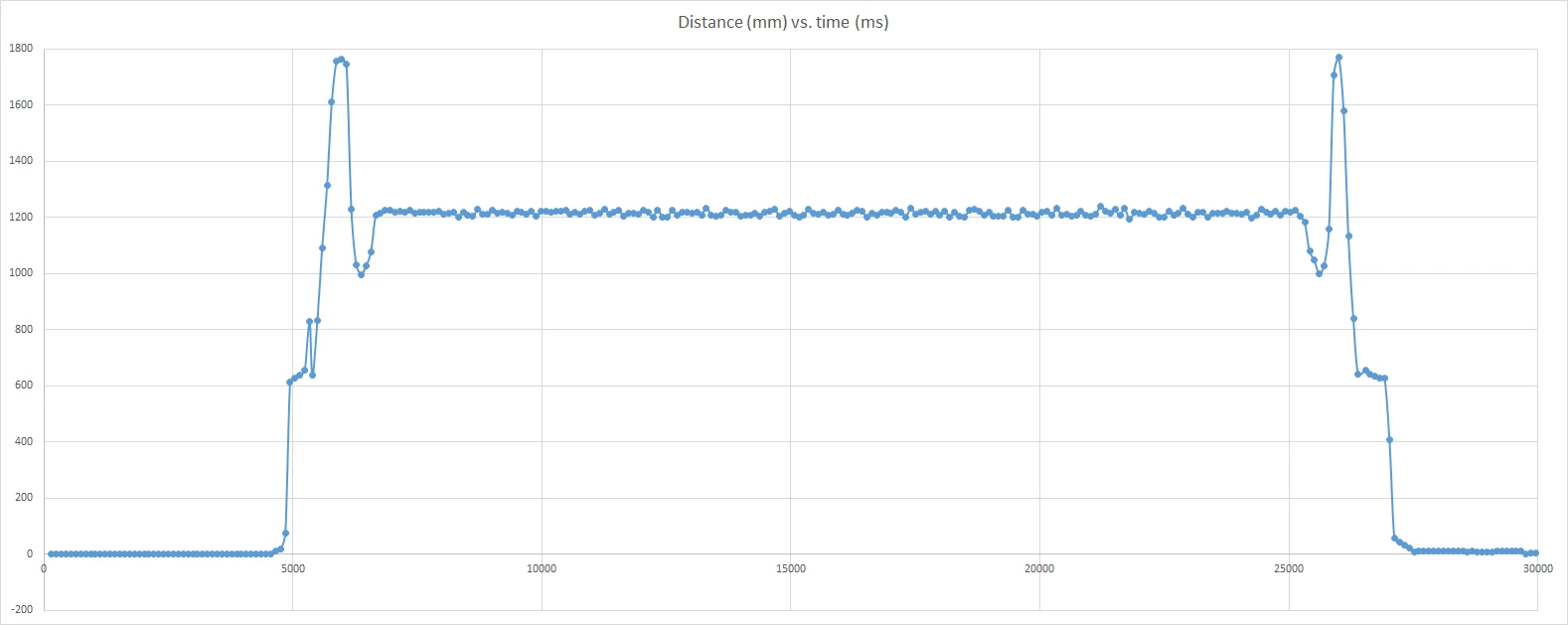

VL53L1X overshoot?
In my initial testing with the VL53L1X, I'm seeing that by rotating the sensor from directly facing an object to facing the ceiling, which is well over the max distance away (I'm operating in 'short' mode, so that should be 1.3m), I get spikes up to about 1.8m at the max acceleration points - when I stop rotating the PCB, and when I start rotating it again. Is this kind of 'overshoot' normal? Interestingly, I observe it with 100ms timing budget/inter-measurement period, but not with 15ms (see attached graphs).
