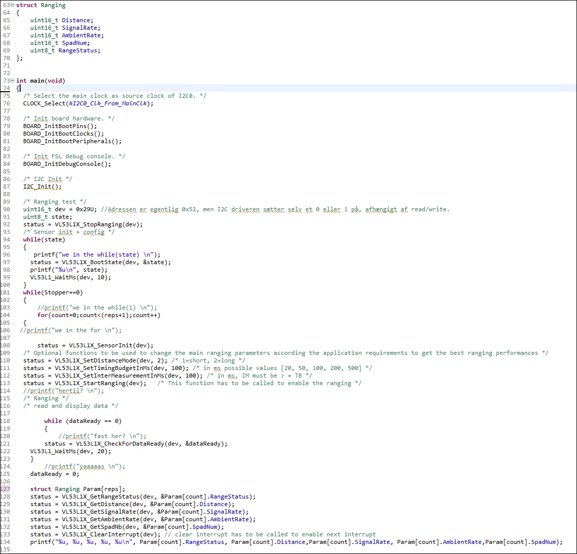

Hi, I hope you can help me with this one.
My problem is on line 127 I'm making an array of structs. i would like to make them global, but if I move line 127 to line 74 (Where my courser is) I get stuck in the while(state) on line 94.
Why can't I make is global?
I've been stuck in while before. if i change the size of the array in line 127 to "10" I'll also get stuck in "while(state)"
Does someone know if I have to call a specific function before powering down (to make me not get stuck in "while(state), or anyone who knows why i get stuck in "while(state)" when i change the code?
