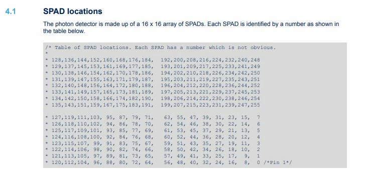

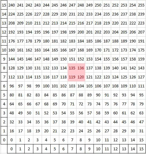

In the VL53L1X ultra lite driver, VL53L1X_SetROICenter and VL53L1X_GetROICenter treat the ROICenter as a single unsigned 8-bit number. Am I correct in assuming this is a SPAD count starting in the top left corner and progressing in a row fashion across the chip?
If this is the case then why does VL53L1X_SetROI set the center to 199 for ROI over 10 rather than something closer to 127?

    If this is the case then why does VL53L1X_SetROI set the center to 199 for ROI over 10 rather than something closer to 120, 121 or 136, 137? The center SPADs in the array.

    I wonder the same thing, but I have no answer so far. Could someone confirm this is how the SPADS are numbered?
    If that's the case 199 is trully an odd value.

    Nevermind, just found the answer in the datasheet ST just upload:
