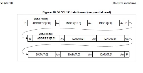

    I wrote some wrong lines in the function, the sensor wasn´t able to communicate with the uC.
    My code didn´t follow the next structure:
    The others vl53l1_platform´s function were implemented without problems, and the sensor replied something, so I thought the problem was in the sensor... ;)
    It was my fault. I had to check the communication with a Logic Analyzer.
    Best regards.
    Jesus Reina
    February 19, 2019
    This is the communication struture:

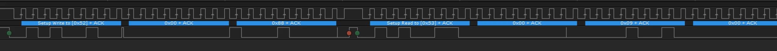

    Hi Jesus,
    Thank you for your quick answer.
    I'm using ST platform code from their example and it seems to go right, It's following the communication structure I think. Could you possibly share with me your platform code ? By private message maybe ?
    Regards,
    Elise
    Jesus Reina
    February 19, 2019
    Hi Elise,
    If you are using the ST´s platform the communication process should be functional. The communication you have attached above seems right. The problem may be in the sensor, is it right? Can you use another sensor?
