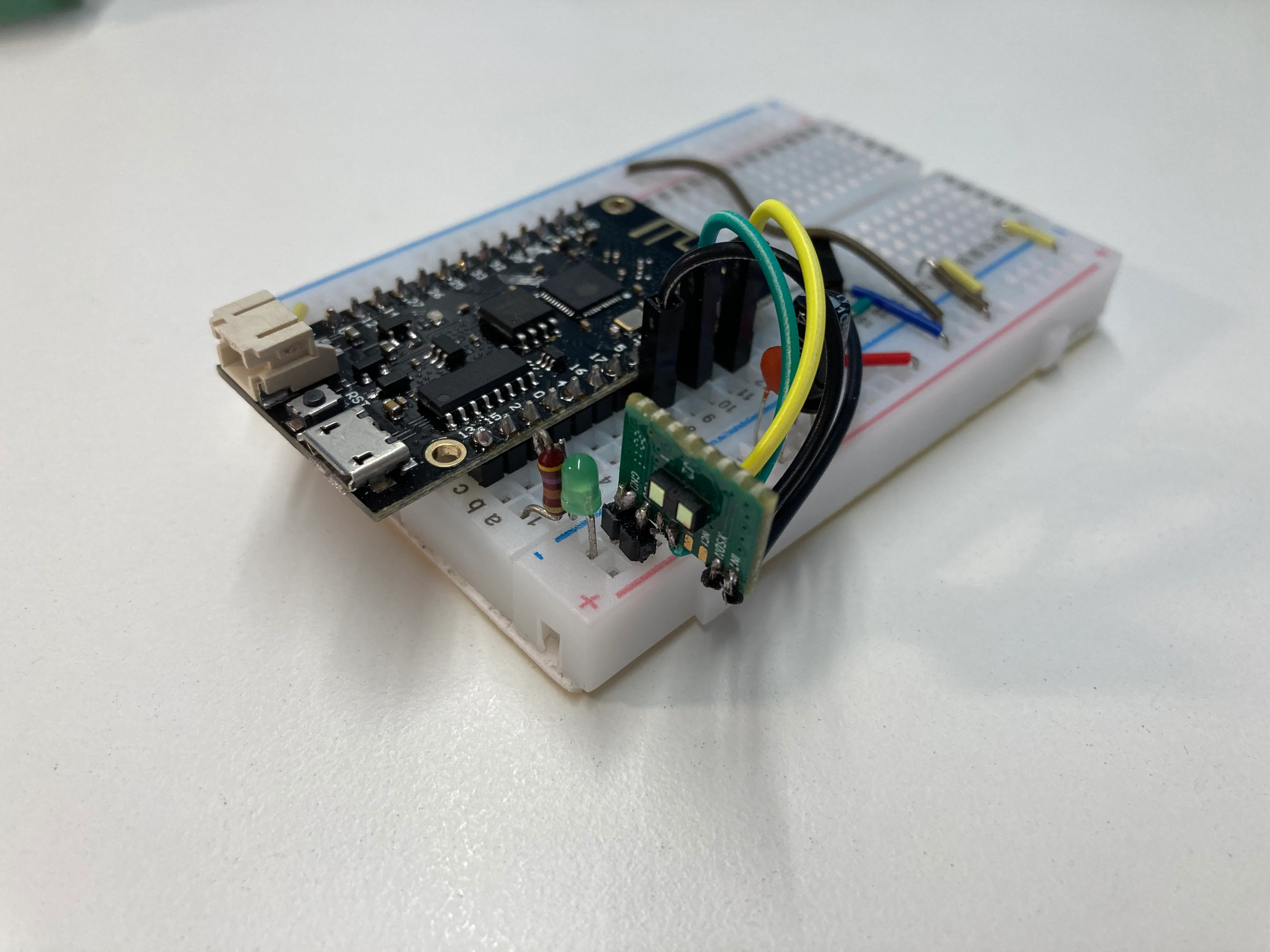

VL53L1 Breakout Boards changes their L2C addresses after Init() and doesn't measure / communicate.
  • March 9, 2021
  • 4 replies
  • 1842 views
Environment: Arduino, STM32F1, ESP32
I2CScanner told me a device has the address #29
Your default address in the sample code is #12
Software: VL53L1_Sat_Helloworld Example
changes:
  • DEV_I2C.begin(23, 22); // I2C 1: SDA, SCL
  •   sensor_vl53l1_sat.InitSensor(0x29);
  • VL53L1 sensor_vl53l1_sat(&DEV_I2C, 5); // XSHUT pin
The do - while loop never will be finished, resp. the LED will never switched on.
The I tested the code with a lot of I2C address scans; start with 29 and in the while loop the I2C code is #09 #0A #14, depending on the start.
I have added a BME280 Sensor, which is absolute stable
I dropped the Clock frequency to 100kHz.
I tested all with ESP32 and STM32F1 Bluepill. Both CPU platforms must be supported in the future.
I tested all already with the VL53L1X, and an adaption its Setup and loop, which worked immediately.
I took the pure chip and solder it onto header and checked it. No result. I'havent stepped into the software driver much. I thought the samples must run first (as all my past sensors are working).
Where can the problem be with this specific sensor?

Here a picture with the ESP32.

March 24, 2021
Fixed, but there is some inconsistency, it seems that there are some activities still open, when the scanner reads the bus.

April 2, 2021
I solved the problem. The provided examples software for Arduino Environment's never worked. I will publish my example and the working solution at my GitHub the next days here. It's running on ESP 8266 and ESP32 and STM platforms.
