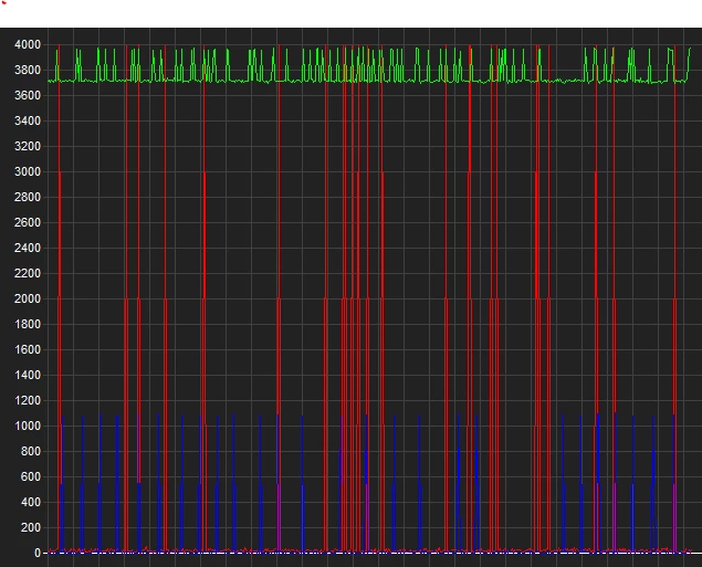

    ​Hello
    Thank you for answer.
    The gravity of the X and Y axes has been changed to the Y axis.
    Additional questions.
    1. When there is no vibration, the X-axis shakes up to 0.1(mg)~3996(mg).
    (View : Capture1 & Capture 2)
    Is it negative mg because the variable declaration is unsigned?
    2. When vibration occurs, the amount of change in the x-axis and y-axis is large.
    capture1
    capture2 (X auxi : It changes rapidly.)
    X auxi : red, Y auxi : green, Z zuxi : blue
    ​capture3 : temperature(satisfactory fine)
    Vladimir JANOUSEK_2365
    Oct 6, 2020 7:08 AM UTC
    I see in your last post that you are using Zigbee communication 230,400bps​
    IIS3DWB has output data rate of ~27kHz (27000Hz). Each axis has 16bit data so 16 x 3 (=3 axes) = 48.
    48 x 27000 = 1,296,000 bps
    1,296,000 bps  >> 230,400bps​ and you have definitely some additional overhead what I see from the text log capture1
    Is not it possible that you loose some data and that you bring inconsistency in the logs you are transmitting ?

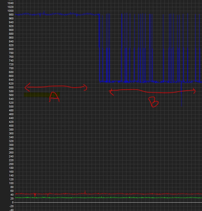

    Hello...​
    Z-axis data fluctuates after block data update.
    Look at the graph.
    Block data updata enabale case (A) and block data updata disable case (B)
    This is my sequence.
    Are there any errors?
    It seems to be the last question.
    ​Thank you....

    Eleon BORLINI
    Eleon BORLINIBest answer
    Oct 15, 2020 2:25 PM UTC
    Hi @Kyouk.1​ ,
    trying to answer to your
    Q2) The hpf adjustment changes position, but the signal is fluctuating.
    Is there another way?
    Please check this thread if can be of any help for you. The suggestion here is to properly set both HP and LP2 filters.
     iis3dwb_xl_hp_path_on_out_set(&dev_ctx, IIS3DWB_HP_ODR_DIV_800);
     iis3dwb_xl_filter_lp2_set(&dev_ctx, PROPERTY_ENABLE);
    /* Into --> */
    iis3dwb_xl_hp_path_on_out_set(&dev_ctx, IIS3DWB_XL_ODR_26k7Hz);
    Q3) When the block data is updated, a noise signal is generated.
    If the block data is not updated, the noise signal disappears.
    Is it mandatory for you to have the BDU enabled?
    -Eleon

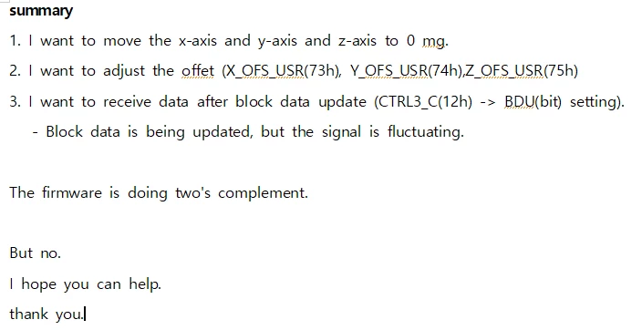

    Hello.
    Thanks for the advice.
    I want to set the X, Y, Z auxi to 0mg(I want to avoid gravity)
    Even if I adjust hpf and lpf, it cannot be set to 0mg
    Eleon BORLINI
    Nov 5, 2020 8:57 AM UTC
    Hi @Kyouk.1​ ,
    it's strange that with the high pass... did you correctly configured the HPCF_XL_[2:0] and the FDS bits of CTRL8_XL (17h) register? (See datasheet, p.36)
    Another way to make the residual offset zero is to use the user offset compensation method. You have to measure the residual offset in a steady state condition and then write it in the X_OFS_USR (73h), Y_OFS_USR (74h) and Z_OFS_USR (75h) registers, so that the chip automatically subtract this value to the output. You have also to set the USR_OFF_ON_OUT bit of CTRL7_C (16h) register to enable this path.
    -Eleon
